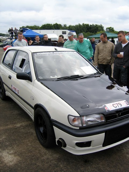

I think we know which car this was...
Yes, this is a photo from TOTB... but I'm pretty sure you said the plates were "TOTB GTI-R".

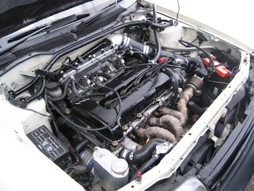

For a 10-second car, it has a reasonably standard looking engine bay. Yeah, you can see that's not the steel exhaust manifold and T28 turbo... but that's a standard plenum (although it is polished and modified slightly to remove the BOV fitting).
Standard fuel rail and FPR (although not standard injectors).
Standard leads (although I have no idea what plugs he's got).
Standard slam panel (although the radiator has evidently been changed to make room for the turbo).
Looks like the PCV is still in...even the battery is still at the front.
Forged internals (obviously), and a big front-exit (that required a bit of work to get it below 106dB at TOTB).
I appreciate that this set-up probably doesn't work for a track car, but I think it shows what you can achieve with these cars without replacing everything.
