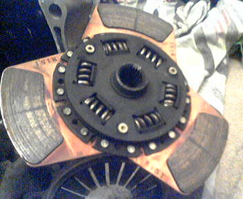

I was wondering if any of you knowlegeable technically minded type people could help me with this.
It was lurking behind the pressure plate when I pulled the box off to change my collapsed release bearing.
OK, can see it's a paddle friction plate, but I di'n't put it there so have no idea what spec it is or awt.
I can see the following markings on the fric plate: KAYABA RS610 S151.
And these on the pressure plate: VALEO NISSAN RS420.
Thing is; due to it being a real tw-t to get at, I think it would be wise to change the clutch whilst it's stripped, BUT......as I've been realy happy with the feel and performance of the clutch (realy hard launching n'stuff) I want to be damn certain any replacement would be the same.
I've searched tinternet for Kayaba / KYB (same thing) but can't find anything on clutches, its like they don't do clutches ?????? !
So absolutely ANY info that you can offer on what I have would be appreciated.

If i was you i'd fit a new clutch while its out, it'll save a lot of hassle later on :wink:
Depending on the power your running a Helix/AP racing organic is probably the best one to go for.

Well....er.........yes. :? Thanks mate.
Jiw.
HOW did ya find that ! :eek:
Certainly looks very similar, what makes you think it's same as mine ? I can't find anything on that site to say it's Kayaba, that said I haven't been able to confirm any connection between clutches & Kayaba ! :cry:

Already established the KYB connection at "first post" buddy'
Not been able to find clutches by KYB on tinternet either though !
Where d'ya get yours from, if ya don't mind me askin. :?:
Maybe I can contact them :wink:

sorry dude like you i found this when i took the box off, mines in good condition so just changing the release bearing
spent 10-15 min's looking on www and it appears that kyb no longer makes clutches for cars..
If you find something post it up please as i'll need a spare as well and if i find a uk supplier i'll let you know

Always kinda comforting to find that someone else is having the same problem. S'pose, a problem shared is a.......... :)
Mine must av been fitted in japan cos I'm 1st. UK owner, how about yours :?:
Yes matey, if I do get any nearer finding a source of these, or even what sort of spec. cerametalic / metalic / organic / ceramic / CHOCOLATE Etc. I'll post it on here :wink:
Just to gauge roughly how much life we have left in our clutches ;....
Ive got 7mm from front face to rear face. whats yours look like :?:
Thanks for your help.
Anyone else come accross these clutches by KAYABA (KYB) :?:
Nij.

if i was you i'd get rid of the paddle (if you want to save your box) the helix organic is rated at 350lb/ft torque which is enough for most people, although srb are selling these new fancy clutches rated a lot higher! RPS clutches they are called - the max organic is rated at 475 lb/ft and will only cost you £305. its a tad cheaper than the helix, only problem is they are new on the market and are pretty much untested. in my opinion i would go with the rps, although i had no problem whatsoever with the helix. the AP racing clutches are rated at 250lb/ft

Not heard of RPS, but maybe give it a try. Thing is I didn't find the KAYABA one that I just took out, too agressive, it doesn't BANG and send a shockwave through the car when it bites like proper racing paddle clutches, ya know, them ones with no cushion springs in the centre.
They're EEvill :twisted: :twisted: Especially when youv'e got SOLID engine mounts :!: :shock: (like me other toy, [onion built for DRAGGIN] )
