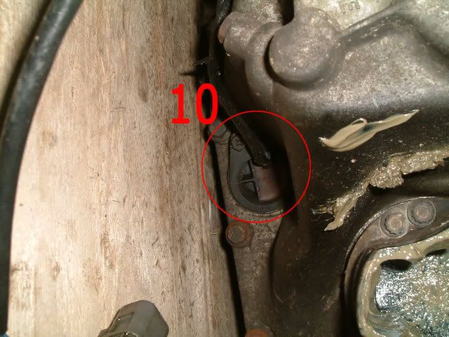

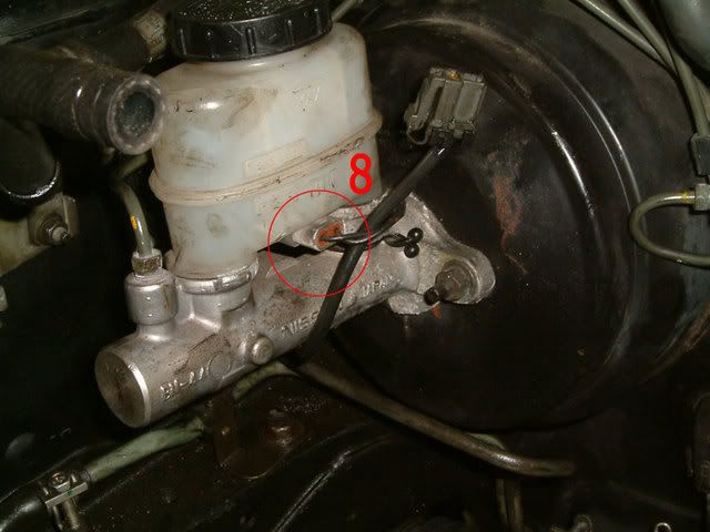

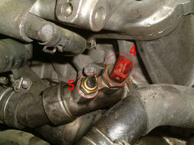

I am currently planning my wiring of the engine bay. I need a confirmation what sensors are they.
Please give me the name for the 10 sensors below.

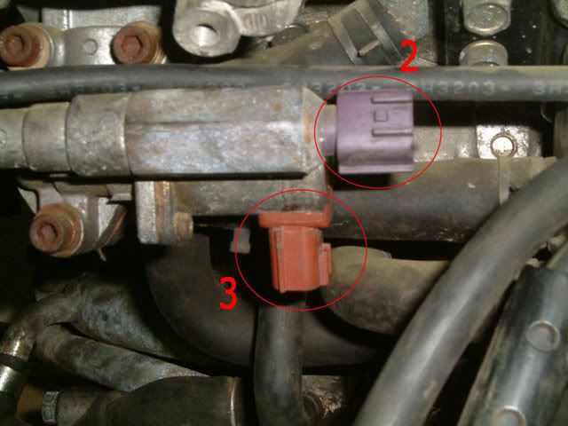

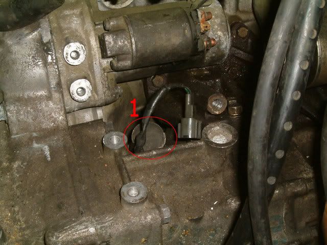

1. speed sensor
2. idle speed control valve
3. possibly cold start device ???
4. water temp to ecu
5. water temp to gauge

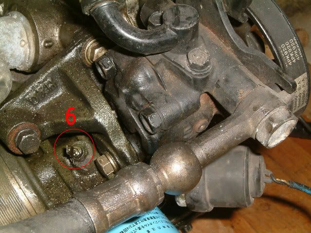

6. oil temp to gauge

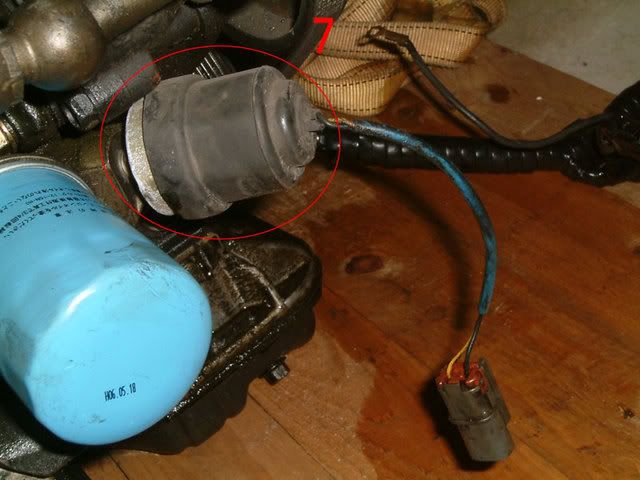

7. oil pressure sensor
8. brake fluid warning indicator

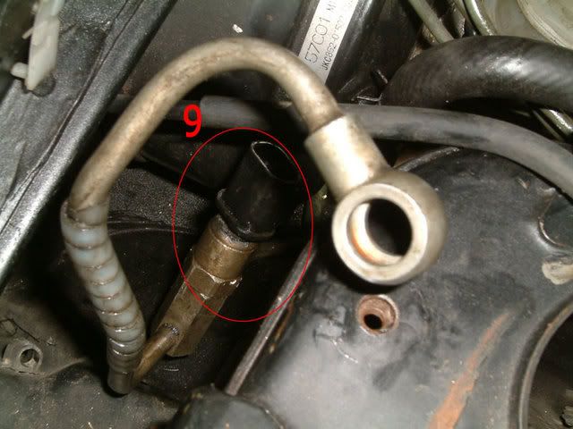

9. looks like power steering sensor
10. reverse light switch

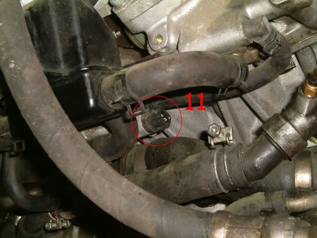

low612
11 is iacv . air regulator . Theres a valve in it which opens and close dependant on temp of motor. #3 is ficd fast idle
gtirx2
I think, 2- is the main idle control valve 3- is to up the idle when you turn the aircon on as this engages the a/c pump and turns the fans on so it ups the idle so it don't idle to low with the drain on the engine, and 11- is the cold start as low612 says it has a temp switch thingy in it witch opens and closes with the heat.
Edited: actully i think 2 and 3 are the other way round i am not to sure now:doh:
Trip
To recap
3 - AAC - Auxiliary Air Control valve
2 - FICD - Fast Idle Control Device
11 - IAR Idle Air Regulator
