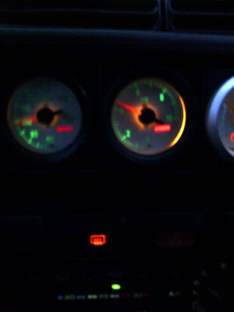

so high oil temperature AGAIN! i was only taking it easy aswell doing 60mph with basicly no boost.

What engine oil did you put in it buddy?, as that can affect the temps if its the wrong grade. Also do you know that the gauge is giving a true reading?, it's hard to tell from the picture as its all blurry mate. The bits you have listed that need sorting out aren't too much hassle given a little time and patience. If you're willing to travel up to Northants then I can take a look at it here at work for a fee.
chrisyleigh
well it went from 80 to being 90 on motorwawhich i though was werid but only started going above 90 if i was sitting at 80ish for a while dont do long journeys but went to 90 as normal was doing 70 ad it kept going slowly so i droped to 60mph and it stayed just under the 100 mark and i used mobil or castrol 10-40

went for a drive before nothing hard abd its defo just changed , was fine but went from 80 to 90 and now gone to 100
also as you can see my boost gauge mustent be plumed in properly as its not showing -hg but is showing boost?
dont understand how it would suddenly rise from 80 to 90 and now this ?

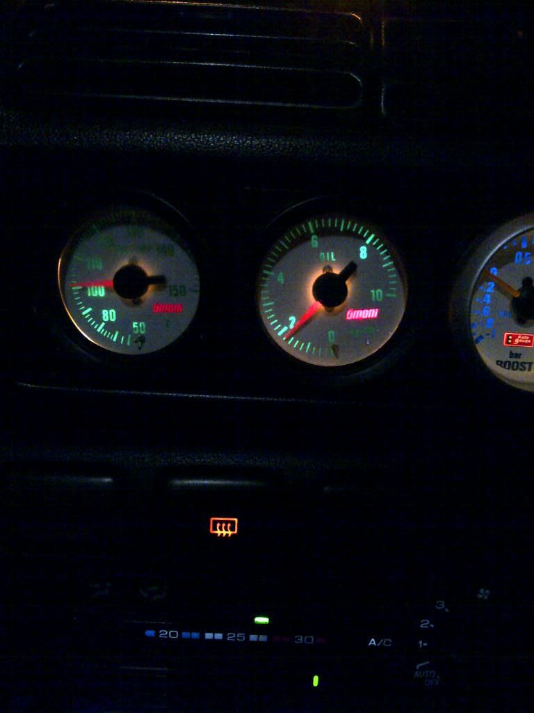

chrisyleigh
the pressure has never gone below 2 aswell im guessing its because the high temp and pic took on idle about 900rpm it changes from 1150rmp to 900 but since the high temp been 800-1000
