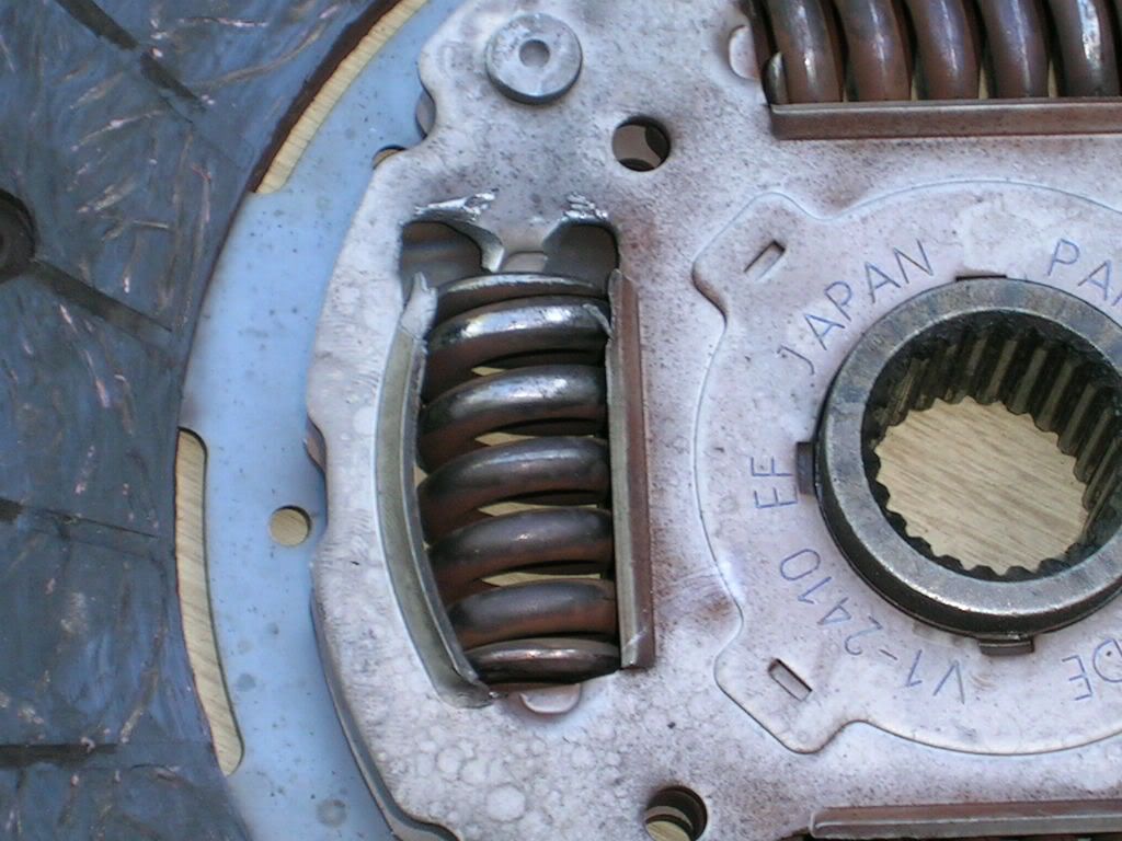

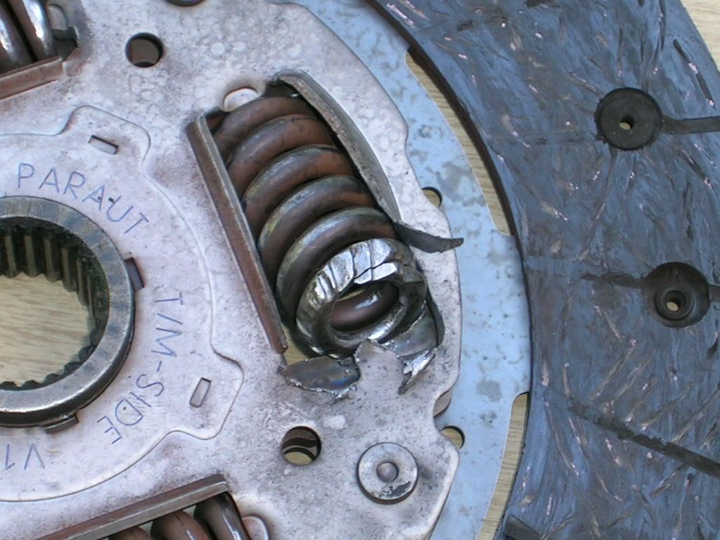

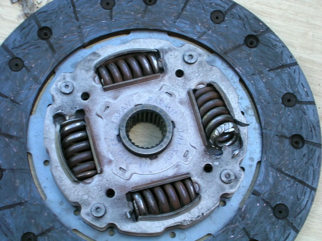

only posting in here as i cant post in problem solving anyway heres the situation. took engine out 6 months ago to find that the clutch had fell to bits, this was after sending the gearbox to be fully rebuilt top to bottom at a cost of £1047 new fidanza flywheel fitted and new rps max street rated at something like 464lb/ft anyway all went back together fine car ran mint put the 3" down pipe on and had it remapped and power came out at 370 bhp and 320 lb/ft which i was chuffed about anyway cut a long story short a week ago started having gear selection problems knew it wasnt the box as this was happening in all gears so had to be something to do with the clutch. took the car to bits today and heres what i found..............
any ideas ...............

Looks like the tension of the springs is too much for the material of the disc :?

i am thinking of trying to reinforce the replacement but dont know how yet ?? but to say that this clutch can take 464lb/ft i thought this was pretty w@nk
kyepan
stress build up always happens at the corners, thats why the AP ones are drilled at each corner, so the round shape helps to distribute the load. If the springs are the wrong stiffness that can also cause the clutch to fail, too much compression, vibration, stress.. bang.
IE, not your fault, send it back to the manufacturer and ask them to put stiffer springs in and drill the corners before they supply a new one.. ;)

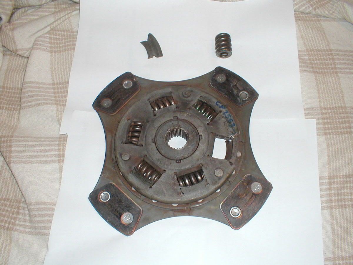

not disputing what you say but dont talk to me about ap clutches as they are even worse to be honest wouldnt have one if it was free. my ap racing paddle clutch lasted 5 1/2 weeks before the spring came out and jammed behind the clutch cover

I'm chatting to RPS about this now.
Daz's car's managed to do this to an AP kit, an RPS paddle and an organic plate now. Very strange it keeps munching plates and it's always the PP side not the FW side.
RPS first impression is that something is causing overstroking of the PP fingers. I'll get more info on this and post tomorrow. Gotta get some shut eye now.

no dooie thats where the springs have been rubbing on the pp due to the wear at the ends allowing the springs to move alot more. but the good news is that the engine came out monday changed drivers wheel bearing split the engine and box obviously choanged the rear main oil seal carrier and re did all my vac hoses in samco blue. tuesday refitted the clutch reassembled the car engine back in and drove it home tuesday night. so no i wont (hopefully) be coming on a tow truck this year boys lol. I think i need a drink or three friday night donations welcome lol.. :lol: :lol: :lol: :lol:

Daz, here's that info I said I'd post for you. Defo something that you need to give some attn to mate or it's just going to keep happening.
This is a chat on AIM I had with Rob, the owner of RPS PP.
[23:28] rpsjerri: Some how he is overstroking the pressure plate fingers.
[23:28] rpsjerri: He may have changed the clutch master or slave with units that have a different bore size cuasing the movement of the pedal to be more than required.
[23:29] rpsjerri: He may have the pedal hieght adjusted too high giving him too much pedal stroke.
[23:30] rpsjerri: He may have the adjustable rod at the end of the master cylinder too long, cuasing too much movement.
[23:30] rpsjerri: He may not have a proper pedal stop on the floor, allowing too much movement.
[23:31] rpsjerri: Those are all the things off the top of my head that would cause the type of damage he keeps having.
