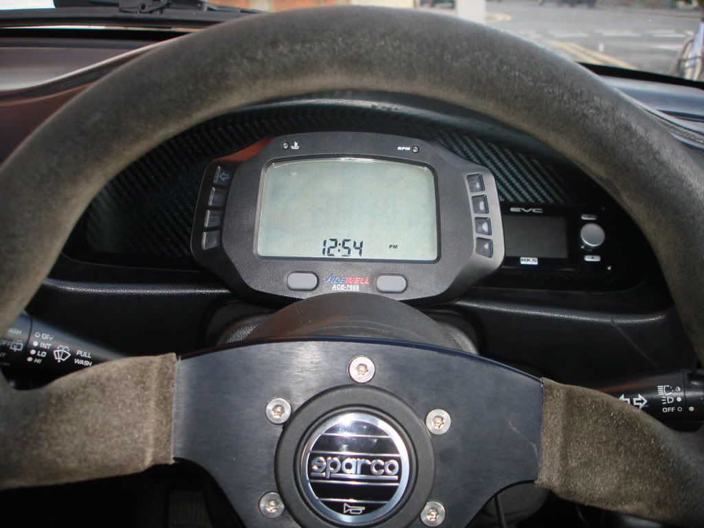

well got an acewell
Gaz gtiR
you cant moan at that for £200! let me know how you get on fitting it & if it works mate. i mite have grab 1 of them myself
nimhbk
well started to fit the thing everything working apart from the important bits lol
anyone know the colour of the ecu tacho wire as i dont want to take it of the HT leads
back gave up so will try again in the week.
nimhbk
Sam looks good if the two main functions worked
they forgot to send the instructions so hopefully have the rest done next week
watoga
I'm pretty sure the tacho signal to the ECU is a blue/black wire. I couldn't get my IQ3 to read the signal though, and had to use an external module connected to the ignition coil. Hopefully it will work for you though.
Good luck,
Dave
nimhbk
Thats the wire i tried, looks like it will be a wire around the HT Leads then!
Also any one know what the spade connector is for of the top of the distributor!
watoga
I used an MSD Tach Driver (part number 8913, as seen at http://www.msdignition.com/Products/Accessories/Tach_Adapters/8913_-_Tach_Driver,_DIS_Ignitions.aspx) to generate an appropriate tach signal. It says this MSD part is for DIS ignition systems, but it works fine with our GTiRs. An alternative is the HT wrap-around (as you mentioned), such as the MSD GMR (http://www.msdignition.com/Products/Accessories/Tach_Adapters/8918_-_Tach_Signal_GMR_Pickup.aspx), but I've been advised that these kits can induce quite a bit of noise into the tach signal. As such, I opted for the coil driver and haven't had any problems.
