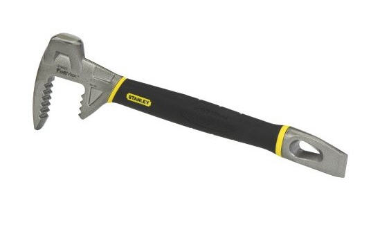

There should be another bolt that, once you have tensioned the belt, you should tighten holding it all in place.
In a nut shell (if it makes sense) use a bar or something strong to push and tighten the belt, while holding, then tighten the holding bolt and that should do it.
Hope that makes sense :thumb:
Cheers, sounds like a plan, what did you lever against to pull the belt tight? Access seems pretty limited being down the back of the engine.
