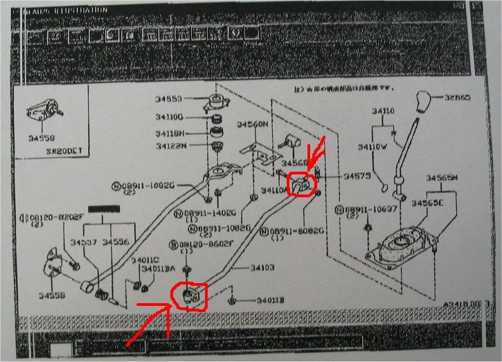

Right i've tried everyone who has been able to get the uprated ones in the past and no one has any spare. I need to get this sorted before Trax this Sunday so Nissan parts will have to do for now.
Which parts do I need to ensure the bushes are all changed from this diagram below they sent me?

PM me if you know the answer and cant reply, I really need these ASAP and Nissan parts are useless for such answers.

basically you have a bush each end as ive pointed out, you need to check for play in these, i cant really make out the part numbers as im blind as a bat!! lol :lol:
but these are usually the culprit for the bad gear selection,

I see...
I cant even see rubber bushes in that pic for that bar :?
I'll give Nissan a call back and see if they can make head or tail of it. Maybe you are meant to buy a whole new link bar. It wouldnt suprise me!

haha yup spot on. You can only buy the bar as a whole from Nissan, plus they want £60 for it ex VAT and better yet i'm not likely to see it until the end of September

I guess i`ll have to order the whole rod from nissan then. Is this the part number for the rod? 34103? and it come complete with new bushes pressed in yeah? thanks

Yes thats right from what I was told today. However he said there was a 3 week wait :?
