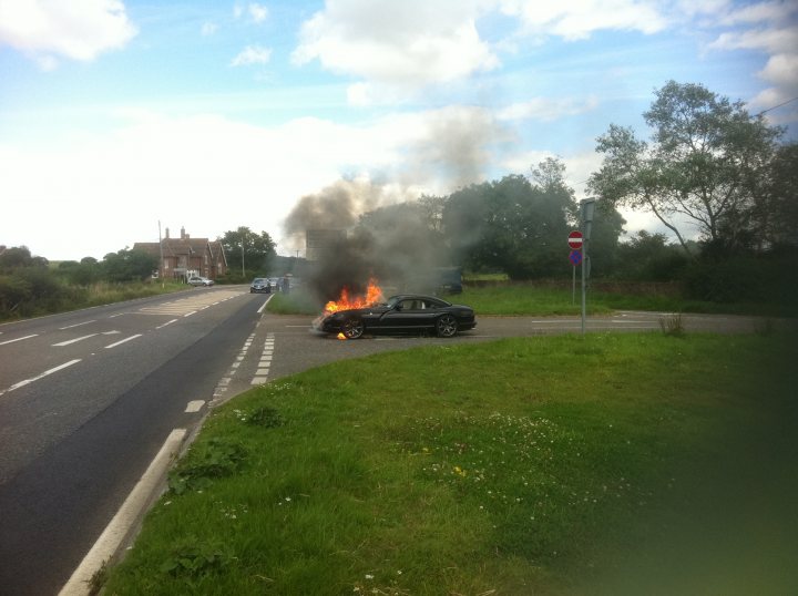

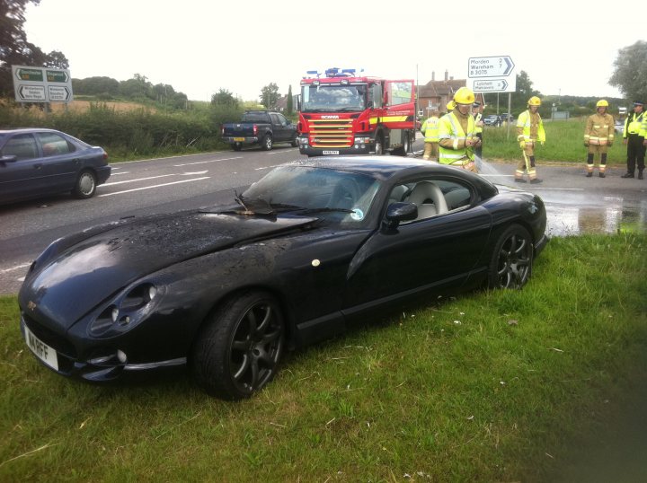

theres a guy on the tvr forum thats just had his car explode at a junction after spending 18k on it, it just had a service but had braided lines fitted which hid the problem.
luckily he got out in one piece but doors wouldnt open due to the electronics going up in smoke by the time he pushed the door button but luckily the overide handle worked and he got out only to watch his pride n joy go up in smoke so was a close call
