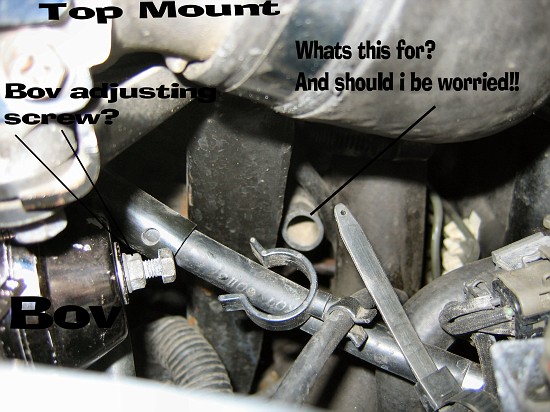

Ok, can any of you kind people help? I have already tried to find the answer using the fantastic.....search facility, but no joy!
First question is-what does that open pipe do? Should it be 'bunged up' or has it slipped of of something?
Also i keep hearing of a pipe which if loose will give unlimited boost(see how that rhymed!) and ultimately send the engine straight to heaven..in lots of pieces.Can somebody post a piccy of said pipe?!
And last but not least-can anybody help in giving a name to the BOV? It has nothing written on it that i can see.Only around the face where it is stamped 'Blow off Valve' iirc.

jiw said:
Its a guide pipe for the screwdriver to adjust your idle :wink:
:eek: How dare you call me laz....ah i see :lol: :roll:
So in essence i don't need to worry about it?! :oops:
That was dam fast-only two questions to go! Come on people!! :p
The pipe that will up the boost if disconnected is the one that runs from the wastegate actuator on the turbo up to the plenum :wink: It wont give unlimited boost, probably around 1.4 bar which would still be enough to kill your engine if you didnt notice it.

Hmmm, you seem to not realise i am an turbo car numpty, and as such have no idea what a plenum or wastegate are!!
Well only a slight clue-any chance of a helpful picture or diagram? Or a link to and old picture?
Cheers for the help so far! :wink:

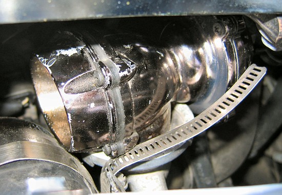

I have a feeling question three could take some time, i imagine there are loads of different Bov's and its hard to get a really good picture of it without removing it. A good reason to get a FMIC!! :twisted:
AJ4
The BOV is an older style HKS SuperSequential ( a good one ). I've got the same one.
That 'hole' should have a screw in it, it looks like its missing ! You don't have a very fast idle do you, by any chance ?

Idle is about 1000rpm which i guessed at being about 100rpm out? Not enough to sound 'wrong' anyway.
I will have a good look for the screw tomorrow :wink:
OZ-Racing
Too slow :roll: All questions answered already :(
I wouldn't worry about the screw in that pipe, I don't think you are meant to be able to see it from that angle. If you are meant to be able to see it, then mine is missing too :wink:

bit worried about the same pipe on my R... gettin a rebuild at the mo but if i remember rightly when i took inlet manifold of you could blow through this pipe and feel air moving inside the plenum..... take it this aint correct?
