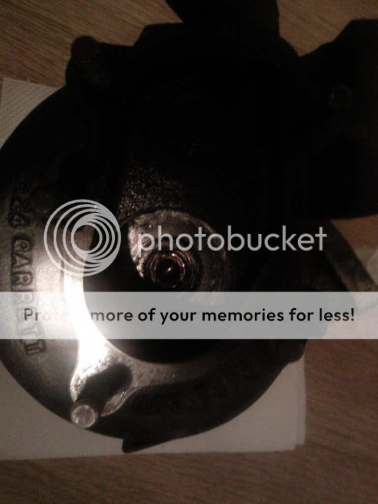

also an idea to check sump as i still have to do this yet to make sure nothing has gone threw the oil return. iv checked my intercooler & found no debree in there?? but its gone sumwhere as this is what happend to mine!! :(
& also lost the rear exhaust wheel. but im hoping a piston ring hasnt let go & gone threw the manifold?? i dont think it has coz there was no oil substance on the exhaust ports on the head when i took the manifold off!! only 1 way to find out compresion check wen ive got sum time. :/
