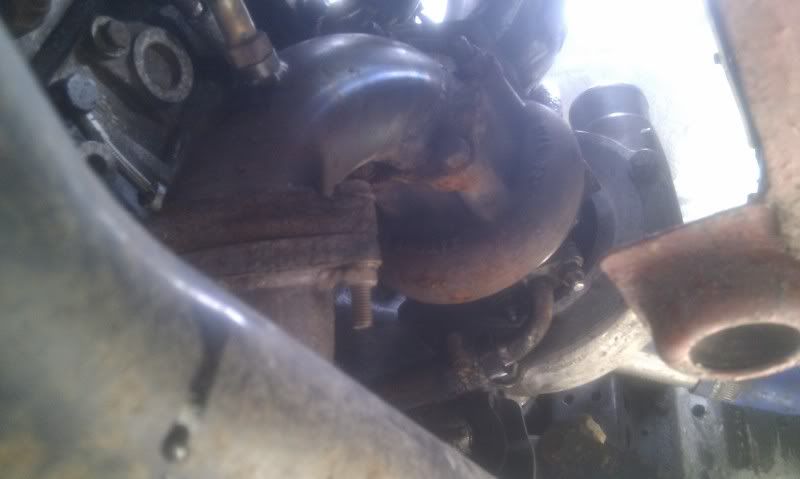

This is the elbow I made, its 2.5" to match the rest of the mongoose system. I think I've got to the power level now where 2.5" is probably a bit restrictive so might have to look at making a full 3" system.
As most people seem to have mongoose systems anyway they'd be better off with 2.5" as if you put a 3" elbow on a mongoose you'll have a big step in the system where the 2 meet which can't be good for flow.
I'd agree with that, I had a 3" downpipe going into 2.5" mongoose and as soon as it was changed to all 3" the car pulled a lot better and spooled faster too.Even though 2.5" is more than enough for the power, it just didn't seem to like that step down.
