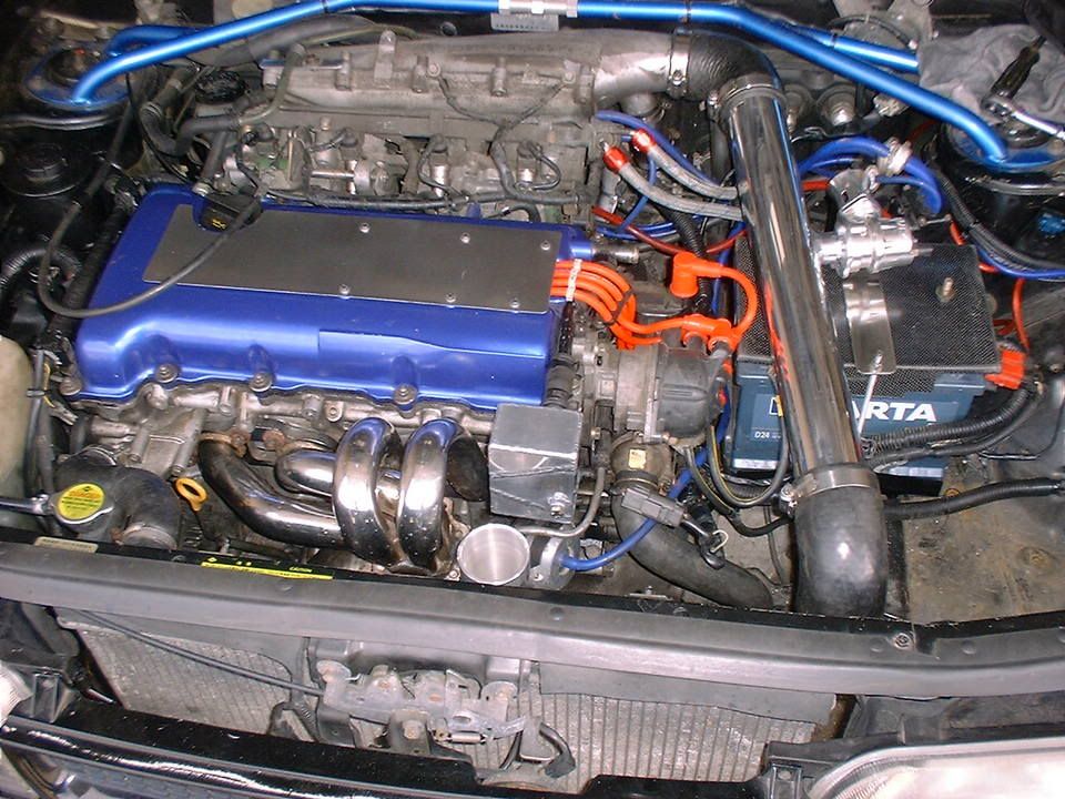

what kind of gains in bhp and torque do you get with tubular manifolds. :?:
do eqaul length manifolds increase power ive been advised they gain lots more torque but strangle bhp.:?:
what constitutes an eqaul length manifold....all headers the same length from the head to the collector on the turbo flange.
i have an ss autochrome manifold and have been told that is eqaul length and when i measured each port it is. 8)
thanks for the answers in advance. 8)
antilag
well that manifold ent great because of the collector but im using it so it will do :wink: its will increase the cars power but buy how much wud depend on wat poer u run ect
also u no to fit the manifold and elbo u bought u will have to rotate the mongoose round about 30 degrees to make it fit or do u plan on joining the two from where they r?
coxie
collector the one i have looks well ,made lots of space and no airflow interuptions etc. :twisted:
i run 1.4 bar on hybrid turbo 8)
when the manifold and elbow are fitted i am going to fabricate a new down pipe that will connect under the car near the centre silencer :wink: i think i will anyway :roll:
antilag
yeh cos the mongoose or standard one points to the left in a way that u wont b able so join to your elbo with out adding an s shaped pipe and reducing flow
u have the same manifold as me mat the collector is totally $hite u need all for flowing into 1 in a perfect world but no1 shoots in from the side aimed at the side of the manifold not into the turbo
antilag
also i think u might find that the mongoose flange on the elbo will b aimed directly over that 2" black support bar thing at the front of the car?
coxie
it is like that but i'm sure there will be a way round it.if not i'll make my own turbo elbow. :roll: :twisted:
when you say no 1 is shooting at the side the pipe on mine is actually facing at a 45 degree angle to the header its self.the part of the pipe on top is cut so its welded but the back half is actually facing down as is the wall inside. :? :D
anyway there must be some advantage over the standard one as its supposed to be a free flowing eqaul length tubular manifold. :?:

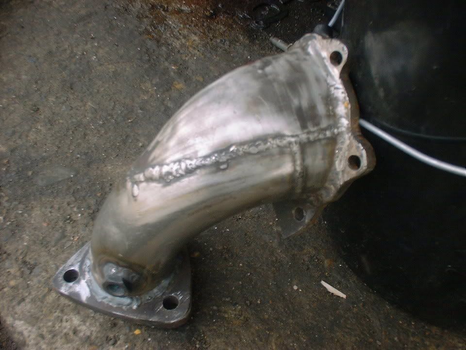

what material did you use for the dump pipe/downpipes?
would it be possible to use the standard elbow and make a new downpipe?
would that have a major effect on performance?
Si..
i've got the std elbow pipe coming directly off my blower with a modded mongoose front pipe. it wont have a major effect on performance but i'd imagine it has some effect, not major tho.
youngsyp
I would disagree with that. The standard elbow is very restrictive. It looks like the diameter of the exit is about 2". The exhaust gas would be restricted before it even gets to the downpipe ? Of course you will see gains by putting an aftermarket exhaust on but, these will come from the bigger than factory pipe, unrestricted boxes and better pipe design.
You should change the elbow as soon as possible. Once you do, you will see a big improvement in gas flow. So, quicker spool up, the lot :wink:
