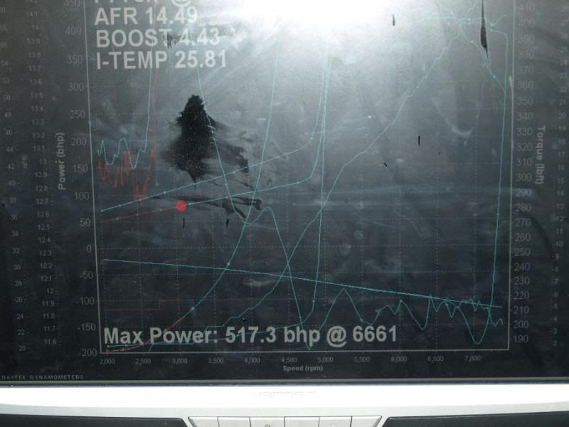

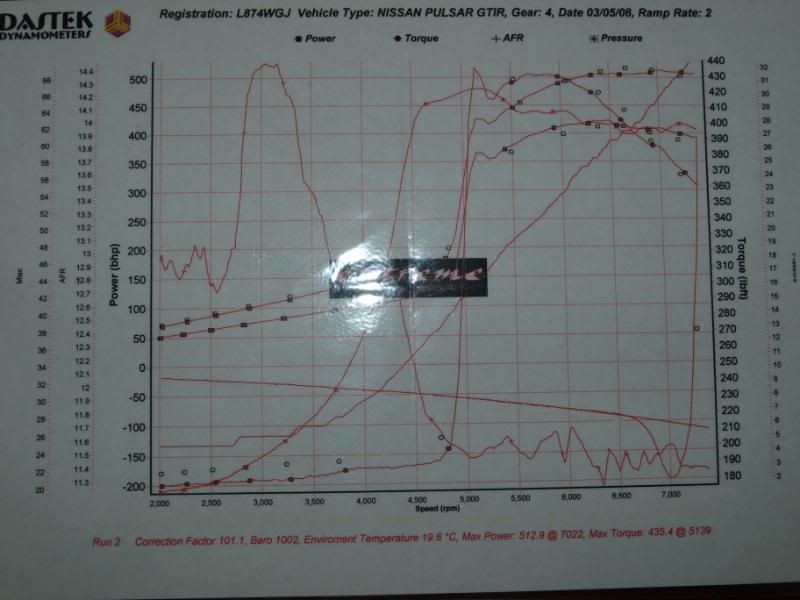

There is no fixed percentage, but the rule of thumb is 20-25%, on 4wd.....the reason for variation is down to dyno types,wheel size, gearbox type,tyre type and pressure etc etc, its all as pobody has said and is measured on coast down on some types of dyno or a preset formula on others....dyno dynamics on shoot44 is 20% hence why when mine made 500.9 atc it was 400.1 atw.
a dyno is only a tool for setting up really,hence why when building and tuning a car use the same dyno and operator to check your tuning as the figures will be more consistent .

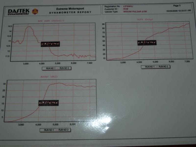

suprised you never twisted the mainshaft right round itself with that graph !!!
bet that felt naughty once spooled up and on boost
what turbo was that on if you dont mind me asking ??? just being nosy
Was using a quaife gear set mate I never had any problems with the gearbox not in ten years of using it, I had it rebuilt a couple of time though just in case, Yes it was ballistic once it spooled up I left a DB9 that I let come up the outside of me at full chat while I just cruised in 3rd when he got along side still flooring it I put my foot down and it looked like he had stopped lol, Was a GT3076 R with external waste gate mate.
