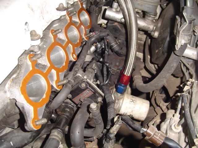

On mine that's the boost source for the wastegate actuator:
That also shows the breather from the gearbox hooked over the fuel lines.

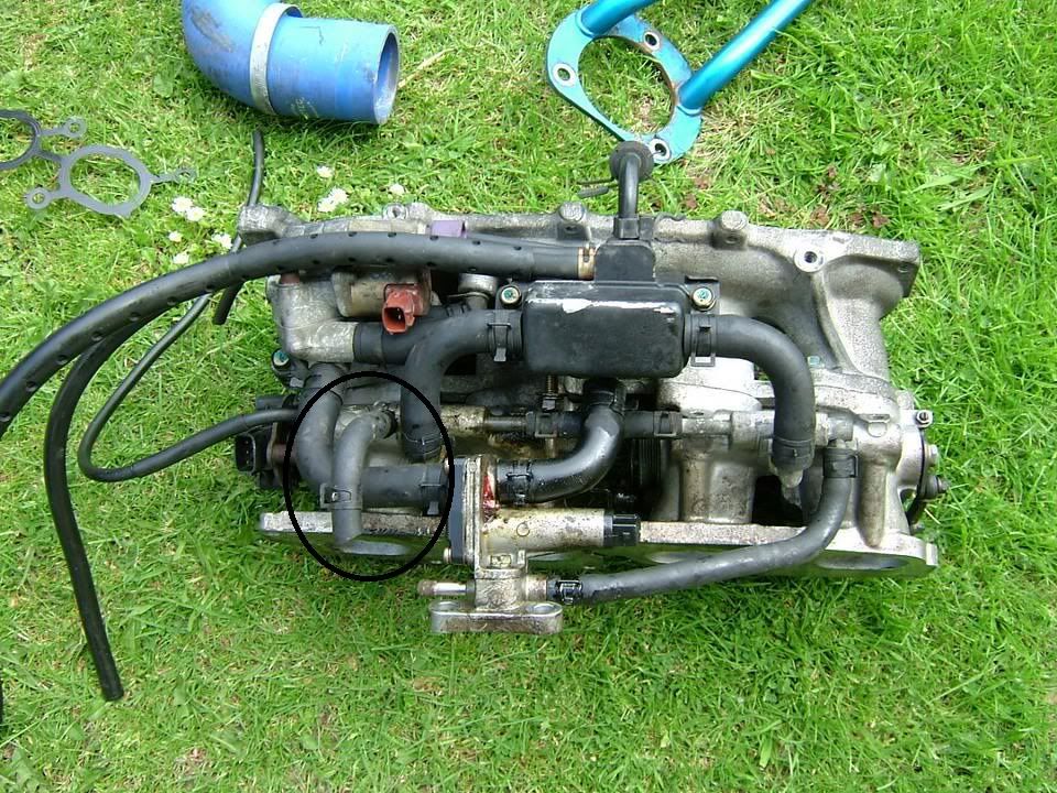

t16coupe
is there anything ment to be connect to the outlet in the circle as i had my transfair box breather mated up to it but was told by a few people that the transfair breather should just be left hanging the back of the engine so i blocked it off but the car seemed to be running a bit rough
Is that one coolant for the manifold; I don't really know?
