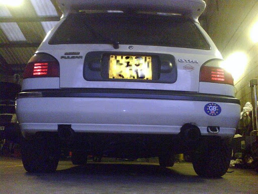

I too am looking for something to silence my mongoose down.The noise is awful at steady speeds and ridiculous when starting up.Anyone managed to fit an extra silencer into theirs?I'd prefer something thats just a straight segment swap so I don't have to chop mine up.
Campbellju's is the best one I've seen; I'm pretty sure it's 3" from the turbo all the way back, but you'd never believe it because it's so quiet. - I'm pretty sure he had to have it made-up.
I have the one which I think was on his car when it came from Japan; that's 2.5" from the elbow back with two exits, and I'd guess it's not what you need.

I've been in touch with Ascar in Sheffield and they've quoted me £100 to fit an extra silencer into my mongoose cat back.I am having my 3" downpipe fitted atm, so expecting the mongaloidoose to get get even noisier so planning ahead before I get an asbo, go deaf or both.It might cost me a bit of power but heyho.
