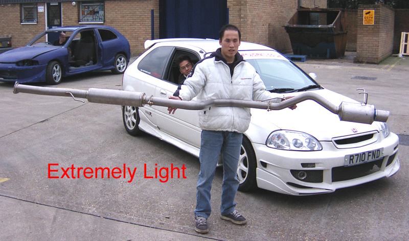

If the titanium bar we use at work is anything to go by it'll probably weigh about 1/2 as much as a stainless one 8)
Imagine how much weight you could save if you went mad with titanium 8)
Apparently a cat back titanium exhaust for an Evo weighs 6.9lbs :shock:
