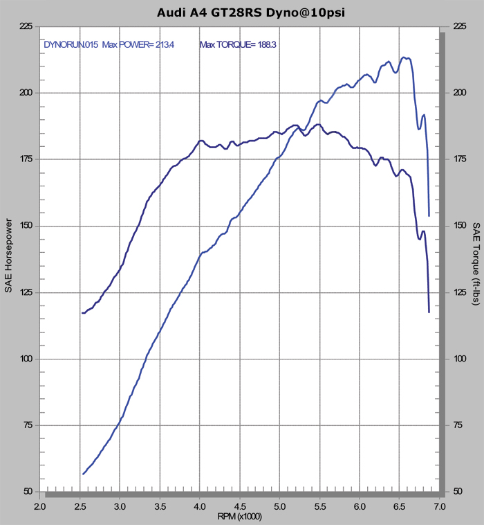

The GT28RS (disco potato) is renowned for being as fast spooler but on this audi engine which would be a high comp to around 9:1 you can see even with 10psi boost it doesn't really hit peak boost until 4k rpm judging by the torque graph :?: thats can hardly be called a fast spooling turbo :?:

don,t mean to sound stupid but how do they measure what power it,s capable of ? for instance how extensive is the (donor) engine modified.is it rated on standard engine running huge boost? what effecieny does the turbo give at say 1.4 bar? rating somthing powerwise seem rather misleading or is that just me being cynical. :oops: how do they back up thier claims,what compressor maps have you seen?
