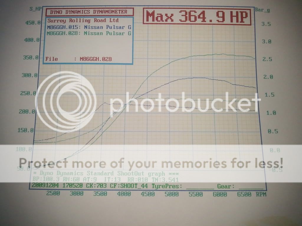

I got the dyno man to put the two graphs of mine on one page, one turbo being the 2860 (quite old at the time, had done 40000+ miles, but it gives you an idea) the other being my current 2871:
As you can see it takes the bigger turbo about an extra 500rpm to reach the same pressure as the 2860 which in my opinion is definately noticable, from driving one then the other. The 2871 has 0.82 a/r, not sure about the 2860 but you can also see the smaller turbo drops off about 6000rpm whereas the 2871 stays strong right to redline.
frit
Well its a tough call, dont get me wrong i love the power that the 2871 gives but as everyone says the limit really for these cars unless you can afford the constant required maintence for 400+hp is around what im running and even then im wary. I managed a 12.8 sec 1/4 mile on the 2860 at the above power (298bhp), went back with the 2871 running 60+ more hp and couldnt get better than a 12.9. I have no idea what the problem was, could have been my driving or the wind i dont know but if the turbo went again (touching wood all around me) i think i would go for a 2860 and run around 330-350hp and gain a bit of responsiveness for b roads and trackdays. That saying, im definately not dissappointed with the way it is at the moment.
