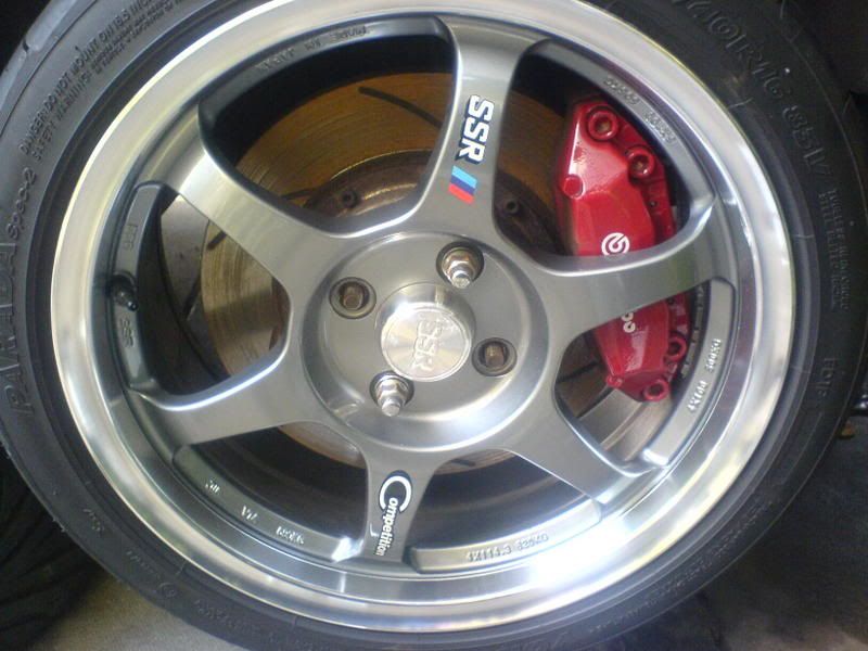

I run 17's due to 330mm AP discs and Brembo calipers but this was all bought well before I had any inkling of using my car as a track car and so needin to source decent track rubber.
