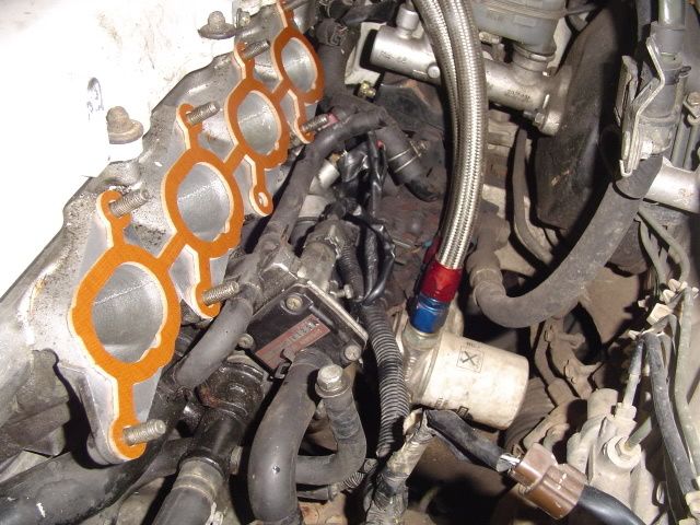

MarkTurbo said:
This is a standard Nissan filter...................keep trying :lol:
That looks smaller than the one i've got on mine?! :noidea:
I need a new one, so I'm better off getting the micra one for ease of fitment. Stumo, was that product code for the smaller one?
