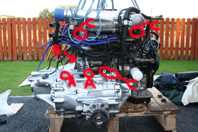

Remove as much as possible like your bov and intercooler pipe etc.
The first thing you need to do is move the big “Y” bracket at the back of your engine. It’s held in by 4 bolts (see C on diagram). You might also have a few other brackets in the way near your BOV, again remove these. With the “Y” bracket you won’t have enough room to remove it from the car but you should have enough room to move it back so you can squeeze the starter past.
Next thing to do is remove the bracket as per A. It’s held on by 3 bolts.
Then you can unbolt the starter motor which is held in place by 2 bolts as per B. The bolts actually go through the gear box bell housing.
Once it’s unbolted you should be able to get your hand round the back of the block and pull it backwards. Be careful as the starter motor has 2 cables attached to it.
To fit a starter it’s just the above but in reverse order.
Hope this helps.

thats it going again now.:p .i couldnt get the bolt off that holds the bracket up by the brake servo so just bennt it out the way and just squesed the starter out that way.i couldnt get the two lower bolts for the bracket to line up again so they will have to stay out untill the engine comes out.
