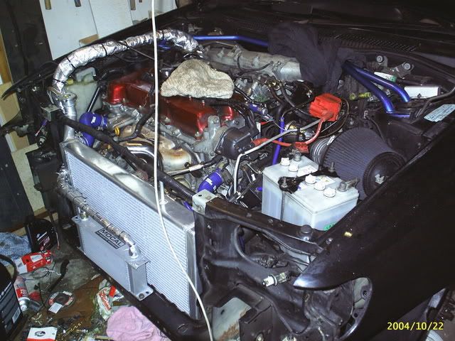

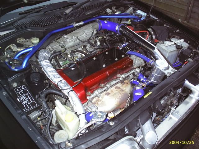

this is about as short as i could get, its not single sided as you asked but hey ho.

Dooie -- Great job on the short piping route, hopefully I wont have to cut through too much metal to get mine setup...we shall see. Your filter looks like it's miles away from the turbo, how do you like the setup?

its made by specR and its about 60mm shorted than standard with a thicker core and a single fan.
this is an old photo and iv got a different filter and hard pipe now but its still in the standard position. not to much cutting for the ic either just a bit from under that bar the bonnet latch attatches to and either side where the pipes go through oh and a little grind from the front engine mount lol:lol:
if i remember rightly there' s been a discussion on here about single sided intercoolers before and it was generaly thought that the air would take the path of least resistance and not flow over the core as it would if the inlet was opposite the outlet...
stu
edit: totally off the wall but id guess you could use two smaller cores stacked one on top and weld the end cans so that the air flows around a kind of loop.
