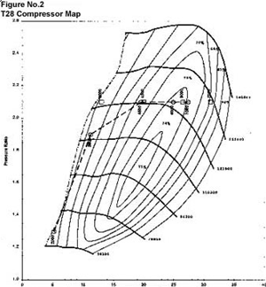

Yes i know...
Here is a genuine T28 Compressor Map
Peak Power @ 1.2bar... 315bhp...
You can run a little higher for more torque...
NOTE - Its the same as the GT28R map as i already said.... :wink:

Yes but Rob was 20bhp up on those rollers too... :wink: :lol:
Just for comparision Sam managed 326bhp @ 1.5bar...
The compressor map shows that the peak power should be... 315 - 330bhp...

turbofriik said:
Most powerful standard turbo Ginga 365bhp
Well what about this compared to compressor map?
Well that is the compressor map for a T28... It even looks the same as a GT28R compressor map as the compressors are the same...
That Dyno figure was taken from one dyno... Never compared with another one to see how accurate it was...
A finely tuned GTiR on here was recently dyno's at 1.5bar on a T28 Hybrid(360deg washer) with a better spec than Pauls car and it made 326bhp...
Pauls car was running 1.5/1.6bar at the time too...
Take my word for it that a Standard T28 is only good for a genuine 315 - 330bhp...
Why are you so concerned about a compressor map based on a turbo thats using WWII technilogy anyway...
1.2 - 1.4bar is where you want to be at with it...
