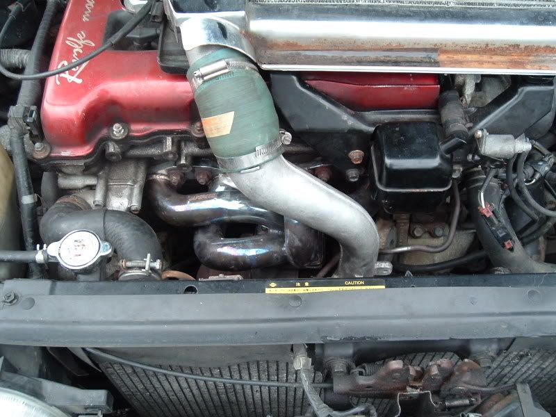

Some pics of it in the bay (ignore rest of the engine, i klnow its a nail as lee seemed compelled to remind me every 5 mins :p )
Note the spacer needed to space the intercooler to turbo hardpipe due to fouling on manifold. Just one of the many things the lads sorted for me.

;-) Does a bit , when it all goes back together you suddenly realise that with a top mont you need a spacer in the intercooler hard pipe . And with only one gasket and everywhere being shut a good sealant had to be used.
So out came the hubba bubba :lol: . Front Mount goes on very shortly so was not to much to worry about . Infact it holds very well but would recomend rasberry next time
Does that mean the turbo wasnt in the same place on the new manifold then ?

SickBoy
no m8 was in exactly the same place just to higher the hard pipe to the intercooler up a tad that was all
Lee
a11ova
turbo is in the same place chap, just that when fitted to the car the top of the manifold sits slightly higher than the stock item so fouls on the hard pipe 8)
