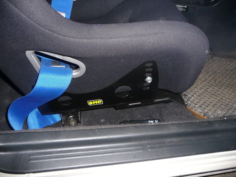

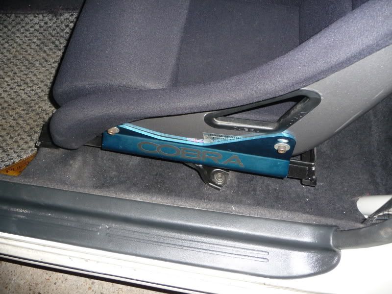

not very clear but few pics here clicky
It's a right pain (as with everything on these bloody cars) to fit seat rails in the drivers side because of the shape of the floor/tunnel. The normal ones that fit, Cobra I think, make the seating height much higher than the OEM seats. So my chanlenge to myself was to make rails/fixed bucket seat mounts that resulted in a slightly lower than OEM position. I did that because the seat is that much lower the steering wheel, even in it's lowest position is to high, I sorted that by modding the steering wheel adjustment thingy. Eventually I was happy with the result.
