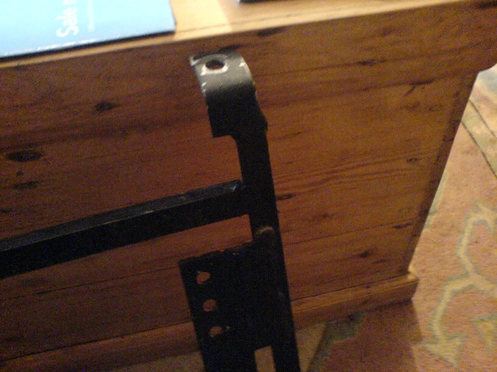

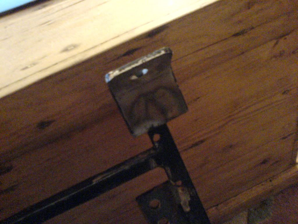

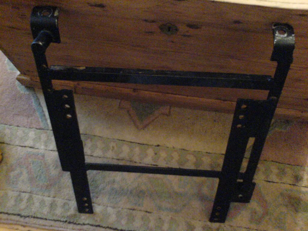

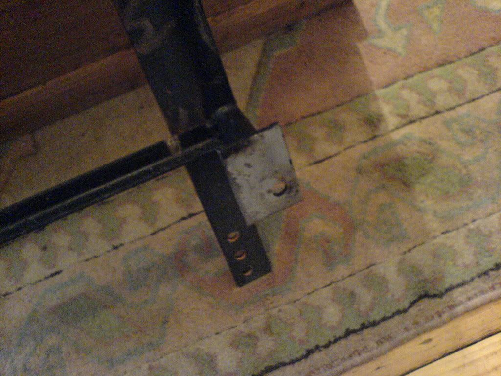

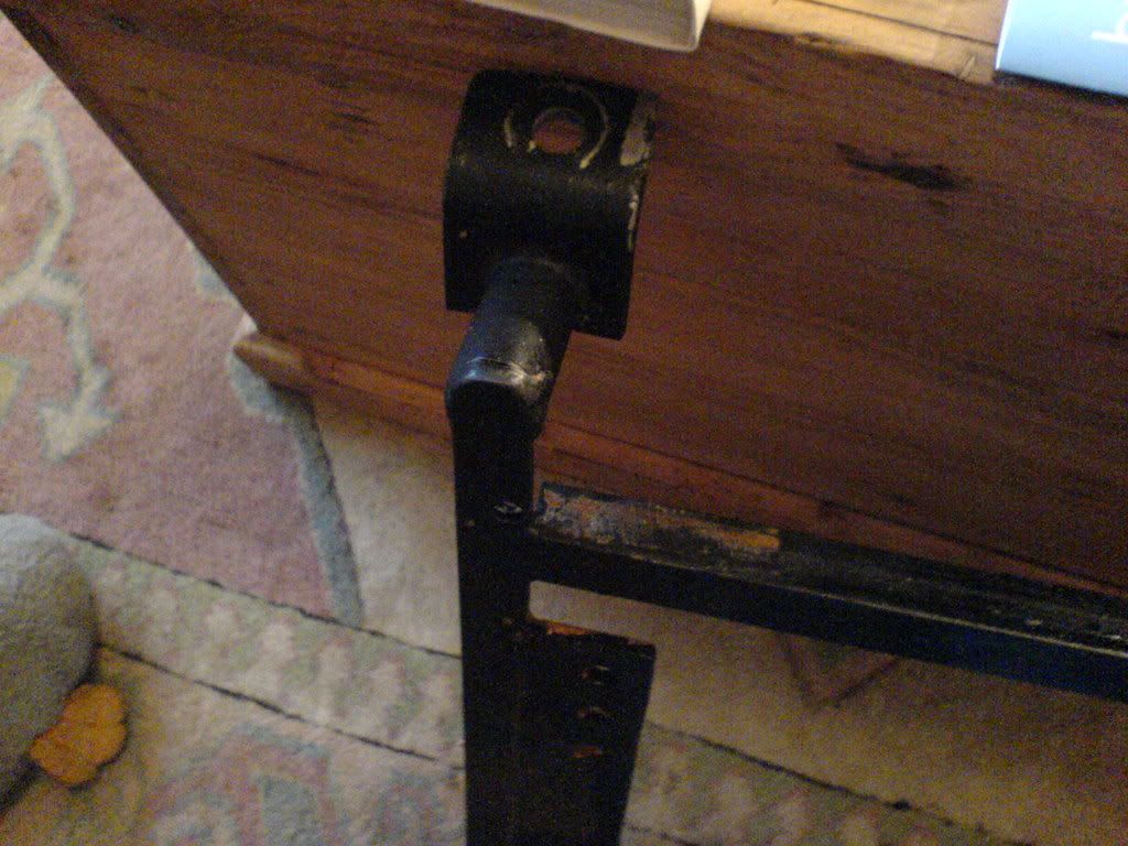

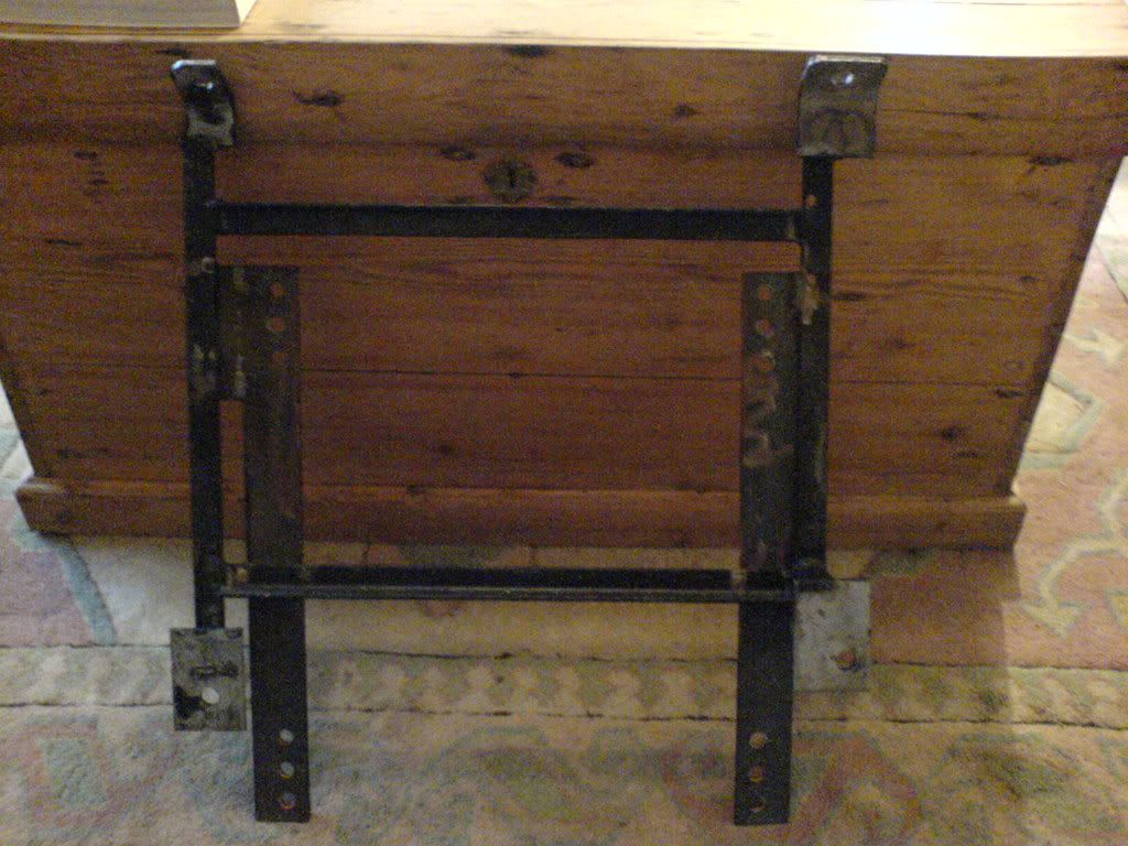

Yes is the answer. I've got a pair of "spare" seat rails from OE seats which I was going to mount some Evo Recaro seats to.
I'll take some pictures of the seat rails tonight to show you what they look like.
Drop me a pm if they are not posted up by the morning as I may forget.
the problem you may have is the width of the bucket seat!
the oe seat rails are quite far apart to accomodate the oe seat, so you will need to make the rail so it comes in further so side mountings can be used, if you have a narrow seat.
Mr GTiR
Yes, Bob is correct so I would keep the orginal rails which the legs are welded to. It's easier to explain once I have posted up a picture.

Here's some picturs of some custom made fixed bucket seat mounts:
