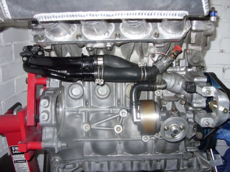

hes not selling up! hes just had a forged engine fitted to his uk sunny and loads of mods to run 400 odd horses, plus a stock engine fitted to another car which is also his but will soon be selling.
he just wanted the rear sillycone pipes fitted whilst we had the engines out (which made sense) but none were available so we fitted stock ones back which will be fine!
dont know where he got the bit from that they were needed to run high bhp though:? certainly wasnt myself!

i do indeed, although i was to cheap to even spend the money on new ones..:lol:. They're only water hoses at the end of the day, wont be under any more real pressure with big power as regardless of BHP the pump can only flow so much water as it rpm dependant.
if i was rebuilding a road car, with a standard set up i'd probably have chucked the samcos on though tbh. The standard ones do get abit brittle after a few years and unless the engines out they're a reet cont to change when they split
