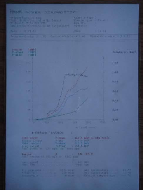

Had my ar at Star performance on friday for a power run. After not being happy with the Profec b settings decided to disconnect it and use a forge manual type of boost controller set at 1bar. On the graph below u will see the results of 220.5bhp at the wheels.:-D The Engine output reading is way out because of something to do with the drag or transmission reading being out. what is the usual loss of power through the transmission with the Gtir??. Done a search and found 28% is this right? Also can someone explain the drag curve? what is it showing and why could my flywheel reading be so far out??

the transmission loss is a fixed value not a percentage ( increases slightly with power level because of the extra momentum though ). If it was fixed at 30%, then a 1000 bhp car would use 300 bhp just to turn the gearbox ;) :D I think its around 40 - 60 bhp from what I can gather on a Pulsar ?

are you running an uprated turbo? its saying 374
No its still standard turbo, if u look at the difference between the engine output 374bhp and the wheel power 220bhp. The engine power is way out for some reason? i was expecting 260-280bhp engine power. Dont know whats up with that reading I would of thought the drag should be smooth curve on the graph?

i got 200 at the wheels and 302 at the fly if that helps.
Cheers for that gives me a better idea of what mine is. Im well impressed with the result if thats the case:D
Its roughly 24% loss through the 4x4 system...
Rishi
AJ4
How can it be a percentage ?
I've got 300 bhp and I'm cruising at 70 mph on the motorway with 24% trans loss so I lose 72 bhp through the transmission.
Then I turn the boost up so my car is now capable of 1000 bhp :D Even though I'm travelling at the same speed, and the same rpm, my transmission loss suddenly shoots up to 240 bhp ?
Tranmission loss is completely independant of engine power, thats why it can't be a percentage of engine power. If it was you could turn the transmission loss up and down with the boost controller ;)
I think we got wires crossed here Rishi as you should know better ! ;) You meant 24% for a standard car at 220 = 53 bhp, not 24% all the time ?
Yes I've always wondered how you can lose more power through the transmission as you BHP goes up, Surely its a fixed thing not something that changes with power out put lol.
Not 24% all the time.... But still 24% loss while accelerating at full throttle even at higher power levels...
220bhp car will lose about 50bhp through turning the drivetrain which accelerates the car at a certain rate...
Now a 1000bhp car will lose more power as it is having to turn the same weight of drivetrain at a greater rate...
The energy needed to rotate/accelerate a drive train increases with the rate of acceleration...
This is proven on engine and then on rolling road dynos...
If I'm wrong then there are a lot of tuner claims that need to be changed... eg RC who managed 700bhp @ Wheels and from that claim 930bhp @ Fly...
Rishi
Don't transmission heat up when more power is put through them? Hence sometimes a transmission cooler is fitted?
So I take it this increase in heat is due to increase transmission losses or something like that:?
AJ4
hmmmmmm, should I believe a tuners power claim..? :D:D:D
I agree that the apparent 'loss' goes up with acceleration, but not power. Nothing in the drivetrain is changing, its the same weight and same rotational mass, therefore it shouldn't matter what power the engine is, the load ( and therefore the drag ) is still the same.
I'll give you that it increases with 'rate of change' or acceleration , because of the extra shearing forces on the oil / mating surfaces etc, but I'm sure its not a fixed percentage of engine power.

GTIR BEAN think you have read the chart wrong bhp is more like 242 if not then thats a 50% increase at the fly wheel . mine made 209bhp at the wheels thats about 259 bhp using the 24% method your at the wheel figure is to low.;)
gtir bean
hmm,thats what it says anyway.it should be more than 250 at 1 bar anyway.it made 289 on different rollers.arent standard r's meant to be about 150 at the wheels?
geoff pine
No your at the fly wheel figure is 302 most people qoute at the fly wheel figures .my own figure is 259 bhp more like .8/9 bar your looks good.
gtir bean
;-) i see.i was going to have a look at the print out but i dont know where i put it now.im sure it will be on the rollers again soon.:p
