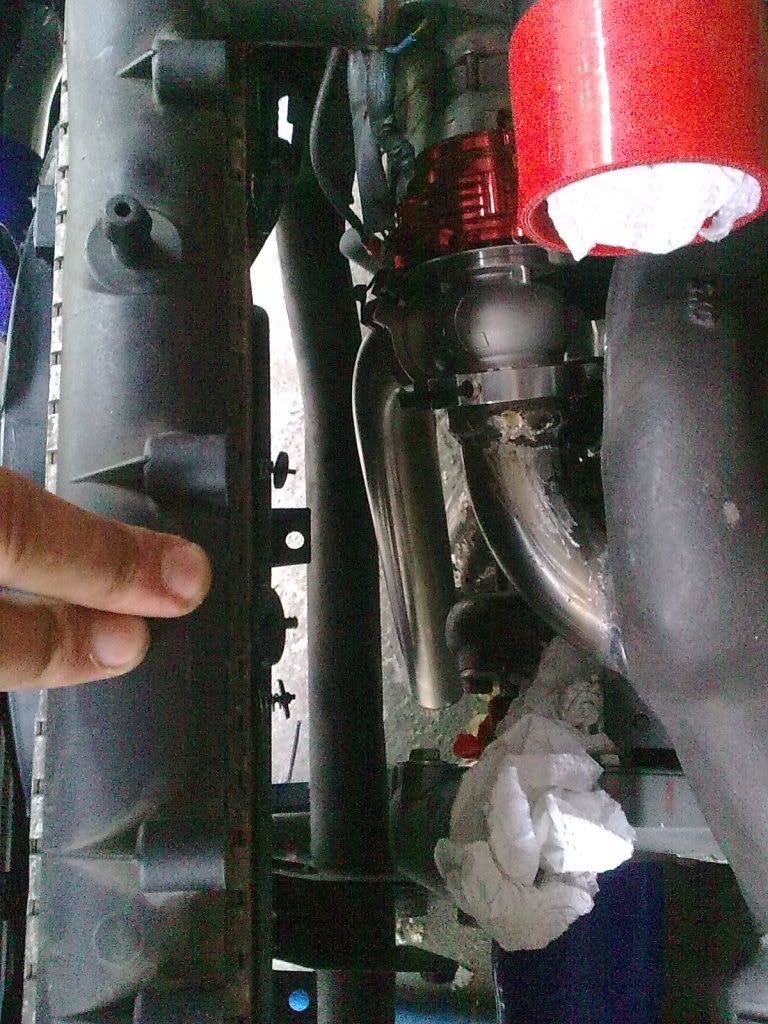

The electro fans from the radiator are really close to the compressor housing and the wastegate pipe which I made.

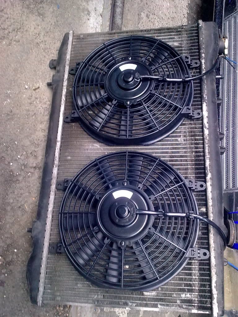

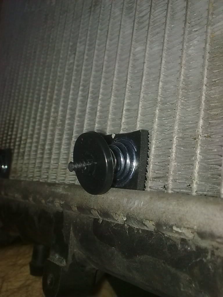

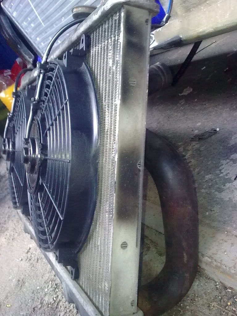

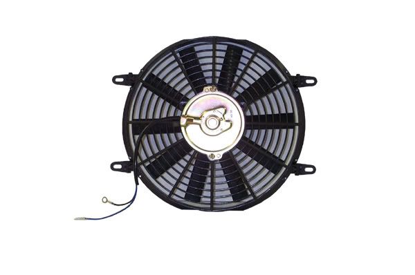

This is what I've ordered.
It is 12'' (300 mm) in diameter with 63mm maximum depth.
Anyway I discovered that my Rad is 35 mm thick (isn't this the size of the UK R????? )so I don't think that there will be any probs.

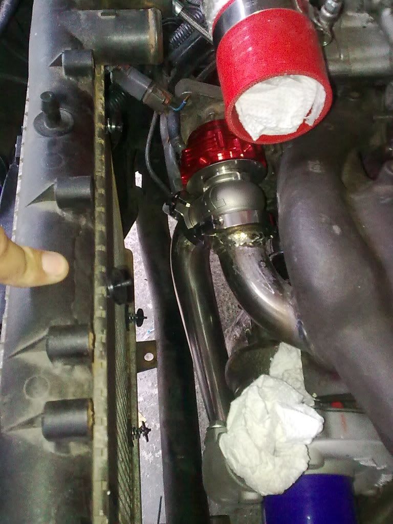

Yeah..........and you will havce also alot of space between the rad and turbo etc.
It's really nice ......check this out.......the space you''l be gaining is laaaaaaaaargeeeeeeee
In the original setup the wastegate would hit the electrical fans.....now.......
