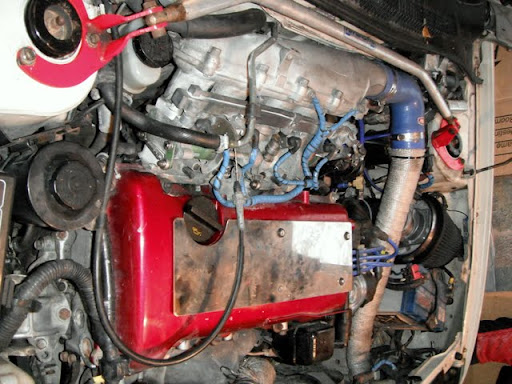

rite ive just done this today.
ive bunged the back of the rocker cover off.
looped the inlet 1&2 -3&4 with vacuem hose.
still got original oil seporator fitted above turbo.
put the breather hose from T peice on the right of the rocker to a catch can (old oil bottle for now)
is this right??
