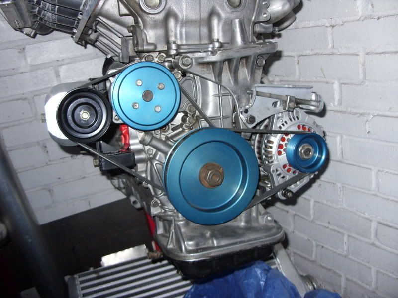

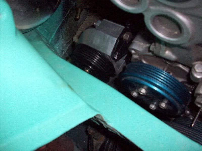

I think the recommended solution is to put a dummy pulley in place of the pump so that you can retain the belt and tension it.
yes you could probably put two pulleys back to back which may line up with maybe a few washers or something as spacers.
yep, i probably have the only power steering delete kit on any gtir i'd imagine. Never drove on it :doh::roll: but i didn't find it that bad moving the car around with no powersteering.
its for sale if the op is interested, £100 delivered.
