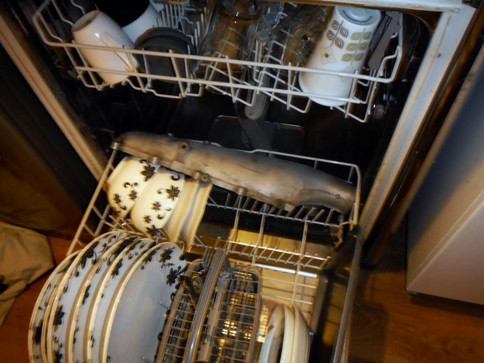

I've got a picture of the back of my engine from when it was out... but it doesn't really help me since it wasn't taken at a useful angle:
