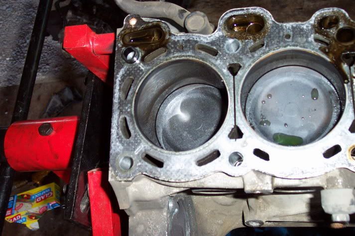

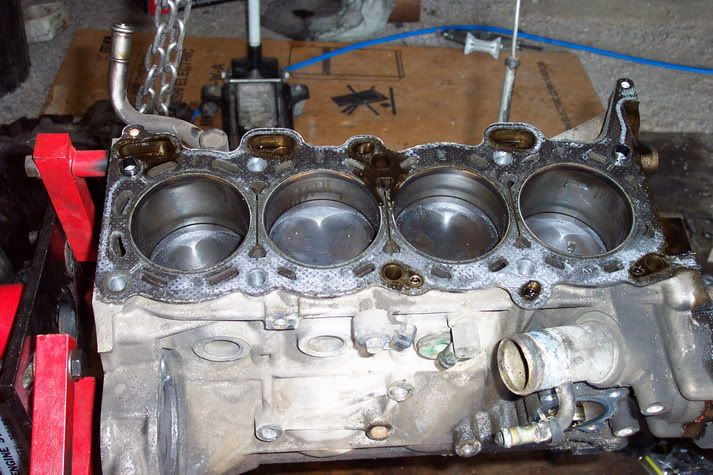

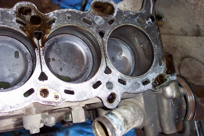

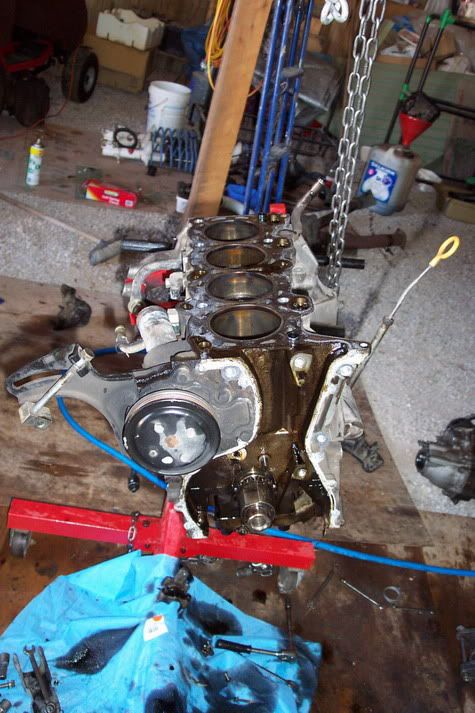

i got bored this week, so i decided to do a freshen up, (head gasket bearings)
well it went from that to a total rebuild. :(
the piston crowns are in excellent condition, but the ringlands are a bit worn, so new pistons were ordered from rocket industries in Sydney, $661 + gst and $15 dollars delivery overnight bag.
they should turn up on monday.
also at some stage in it life it's been sized/spun bearing ect, so i am hoping the main journals are still straight otherwise, it's getting line bored :(
AND they changed the crank to a s14 one :(
anyways here are some pics of the motor with the head off.
