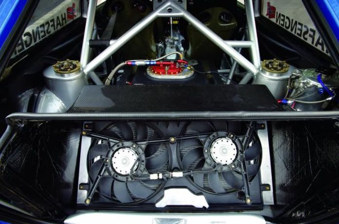

I was looking under RC devlopments green evo 6 few weeks ago as my friend is driving for RC in time Attack and notice the rad was in the rear under the boot floor. makes a lot more room under the bonnet. has anyone done this on a pulsar?

Why I put this post you a few days ago, I'm going to have a go , But you got alot to look into, ie: drag, getting a decent airflow through the rad, making sure the water flows well enough etc
http://www.gtiroc.com/forums/showthread.php?t=53425

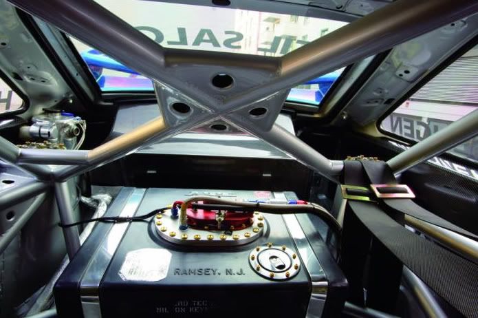

This is the Escort Cossie from Norway, this is the best set up its had so far, never had many if any problems with over heating, the current setup is the remake of the 2nd and works well. I'll find pics :)
