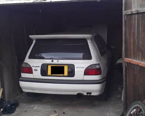

The 'R has been dry stored in my garage for the 2 years and yep the handbrake is off!

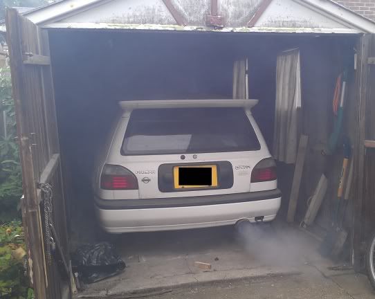

Got started on Sunday...it's been a while!

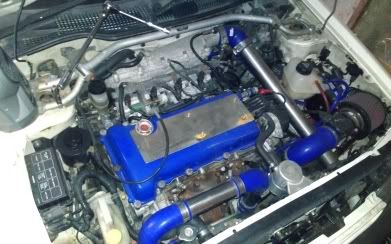

Cracked the bonnet open...looking fairly clean to say its been sat in the garage for 2 years -

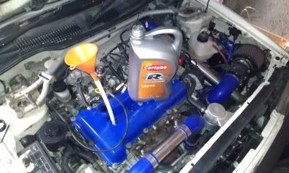

Checked oil levels, coolant then removed all sparkplugs and put a drop of oil down each bore. Left for just under an hour to soak, added some fresh v-power.
Went to start it after connecting everything backup and the starter had stuck...so got the bigger battery out the VR6 after wasting the GTiR's one & after rocking the car and a few more cranks the starter turned it over, then it fired! :twisted: Had a big grin on my face, before having to evacuate the garage as it burned off the oil! :lol:
So far, so good! Can't engage gears due to the clutch slave cyl popping its seals so got a new unit to fit tonight hopefully & if that bleeds up then I'll try a few runs in & out the garage! :-D
