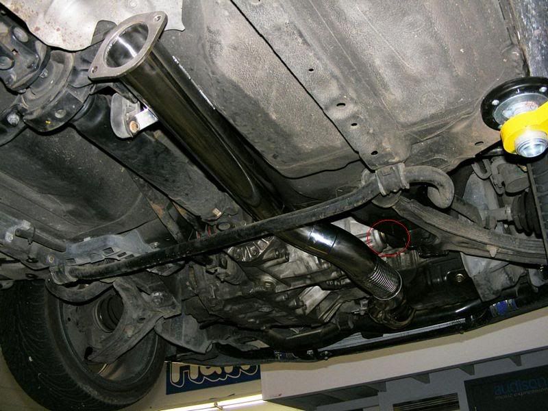

there only part codes anyway, the actual part number is different
hang on a bit and I'll load the part number (nissan fast) program
not sure which seal your after really have you nakerd the round rubber seeal that sits in the transfer case or have you damaged the mating/sealing surface on the shaft itself
is it 33111 or 33142 in the last pic above

Basically had my gearbox out and a uprated clutch fork put in and now it leaks from the passenger side shaft wear it enters the box.
It has the big rubber boot on it still intact but it moves away from the box and then that makes it piss out with oil. I dont really know myself to be honest. Could you give me both numbers and i'll buy both. Actually can you give me both ns and os. might as well get both replace while i wait. Cheers Steve
are you sure the shaft in question is pushed in and located properly as it shouldn't just fall out, it locates quite firmly, enough so that to get it out again you have to use a pry bar and lever it out
33111 - 56E00
33142 - 56E00
