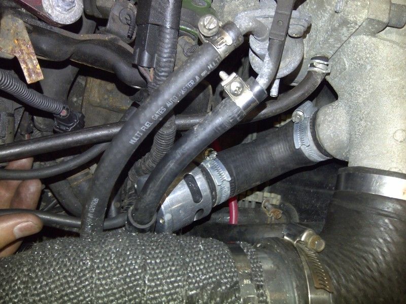

While fitting a new turbo, I replaced the dump valve from a ARC thing (that didn't work) to the std issue Baileys, but the old one didnt have the thin vacuum pipe connected
can someone confirm that where I have connected this to/from is correct please?
Its connected to the inlet manifold right behind that green bracket thing-

Ok, well the baileys was cheap so if it doesn't work I'll get something better :)
So can i just T piece that pipe for the FPR into the same pipe thats connected to the DV? Its never been connected since I had the car

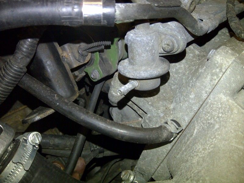

My other vacuum pipe is split into Fuel pressure regulator - no pics of that just now, but I'll get one and stick that up too (worth making sure thats done right too)

theres another vacume port on the back/underneath of the throttle bodys you can connect you fpr to. you mite have to get a mirror in there to see it.
My car runs fine with a baileys btw

is there still a separate fpr beside the strut top (blue thing)
cos russ fitted that when i got it mapped at wallace. if so u shouldent need a pipe on the standard one.

Aye the FPR is still fitted and plumbed in, it has a vacuum pipe attached. So that overrides the standard one then I am presuming :)
