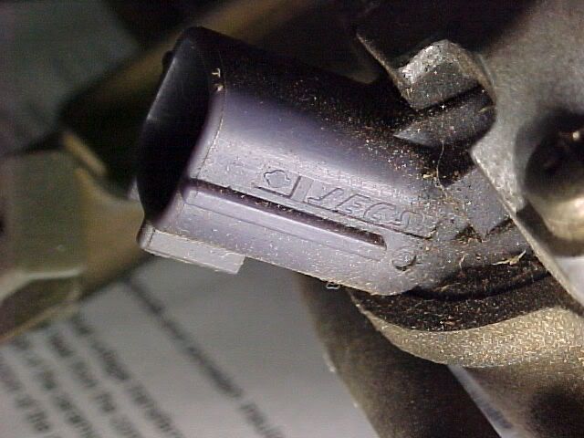

Does anyone know what these injectors could be...?
A mate of mine has pulled them of a standard GTiR that he had been working on and is a little miffed...
Any help would be appreciated...

i wasnt aware their had to be, if he wants a standard set throw em my way, unless somebody has painted them :oops: jeff

thats not a R fuel rail looks more like a 200sx or blue bird fuel rail to me and the injectors are also side feed where R injectors are top feed

Thats what i thought... I looked at it and thought that it didn't even look like a GTiR fuel rail...
Found out that the inlet mani was different too... Looks like the GTiR has been running around with a 240SX engine... :shock: :shock: :shock:
It was running like poo so was broken up for spares.. This is just one of the items left over...

Just thought can't be a 200sx or 240 as their rwd and the manifolds are totally different aswell as the dizzy etc.
Chances are it will be a bluebird engine just slapped in their to do the job.

THAT IS SIDE FEED INJECTOR
purple colour side feed with JECS
mean STOCK SR20DET U12, U13, W10,W11, S13, S14 early
370cc
370cc
Yep, same as my S14a. purple 370cc side feed
