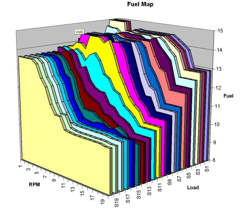

As an example, here is what a standard fuel map looks like. I have converted the figures to 'target afr' so you can get an idea of what the fueling is doing. I prefer looking at maps in this way although it takes a bit of getting used to. The very front of the graph is the highest load / highest rpm point, and going back into the page the rpm and load decreases.
You can see that round about the low idle / low load cells that the target afr is around 14.5 - 14.7 : 1 which is fine, and at high load the target AFR comes right down to 9.5 : 1. This is very rich ( everyone knows the standard map is rich :D ) and it is only what the ECU is trying to achieve, in reality its more like 11 :1. You can see on the map that after a certain rpm and load, the ecu just throws in as much fuel as it possibly can.
Overall the standard map looks about right, even though its has a few steps and lumps in it that could be smoothed out.

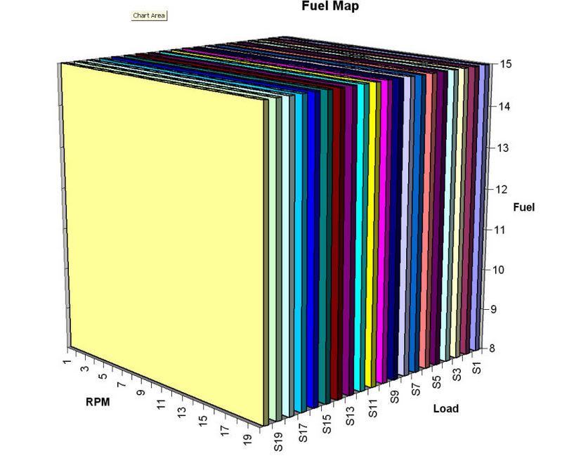

By comparison then with your 'tuned' map, this is what yours looks like -
In other words, you either have a severe problem with your PFC or its not tuned at all....

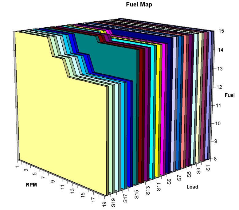

Here is what your friends map looks like, it is not much better than yours -

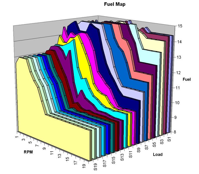

Here is a typical map from 700cc injector / big turbo -
Thats what your map should look like... :(

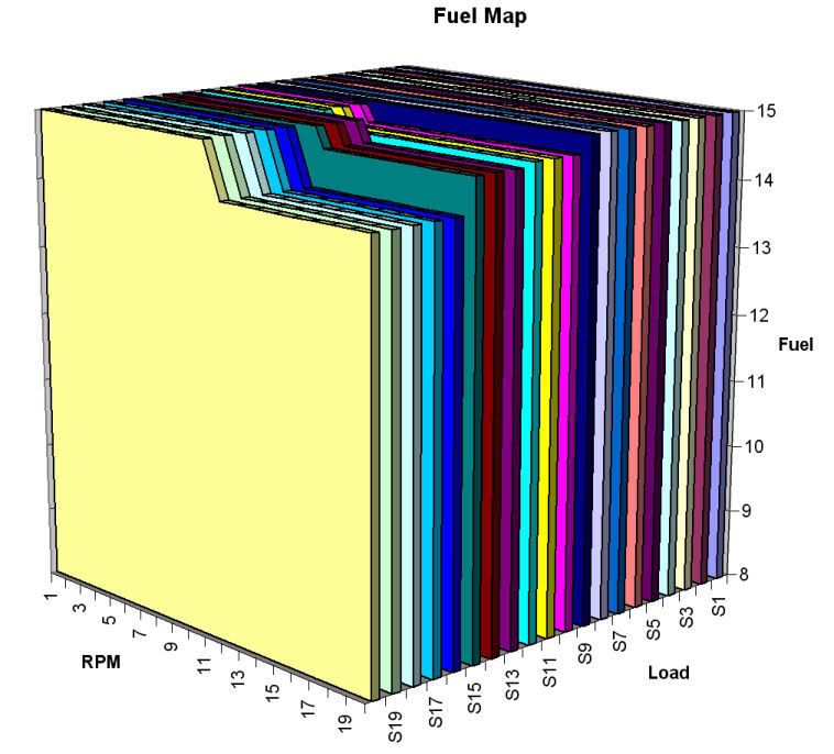

Oh my God !!! Just seen the last map you sent, its not tuned at all !!
Bloody so called tuners, this is why they have such a bad name ! I think I'd be getting in touch with whoever mapped these cars and asking for a refund, your very lucky that none of them have blown up.
I can't beileve that those maps are real, are you absolutely positive you are extracting the data ok from the maps ??
