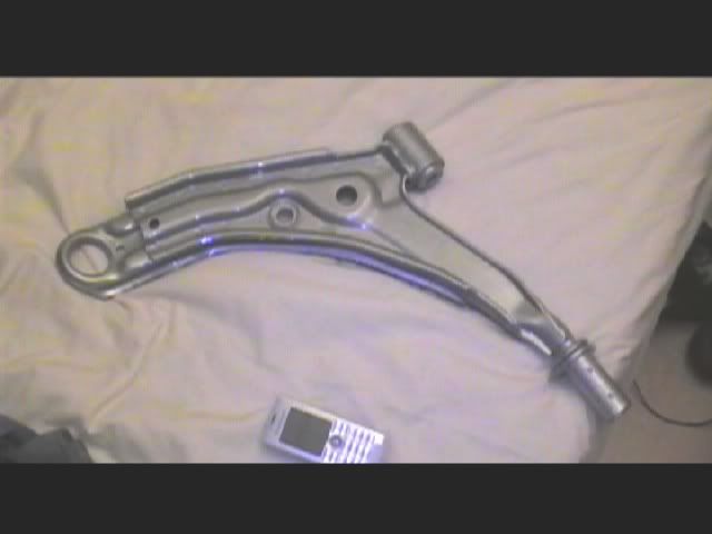

am in the process of rebuilding the lower arms. was thinking about painting or powder coating them to look better and stop rust. what have peeps done painted or powder coating? is it worth doing them or shall just stick the bushes in and slap them back on?

what normal paint etc? and why did you reweld it, was the weld breaking or something?

If your on about the lower wishbones, they are only stitch welded and IIRC in the Grp N manual is says to weld to strengthen, I got a spare pair sitting outside going rusty which Im meant to be doing!

mike welded them up for me 8)
when you get them off you'll see what nad means about the factory welds, replaced the ball joints aswell whilst they were out, gave them a good clean and roughened them up abit re-primed them and just used hammerite to re-paint.

powder coatings the best paint going for metal but its not something you could do yourself unless you work in the business, and its something you want done properly especially for a part like this which is exposed to the elements.
for ease just paint them yourself with wetpaint and chuck them back on.

that does look good!!!. just had a few quotes for powder coating and most adviced me that i get them shot blasted because of the rust,will cost too much so will just wet paint them.

aye they would defo need blasting mate i had to do Tony's coz powder coating has to gel to fresh bare metal, you also need 3 coats of the stuff primer colour then laquer, it by far lasts the longest over any other paint.
