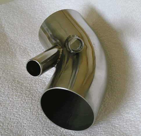

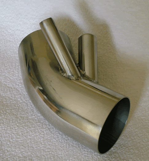

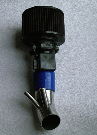

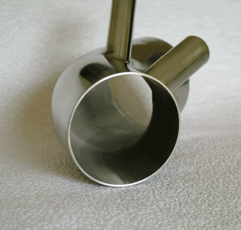

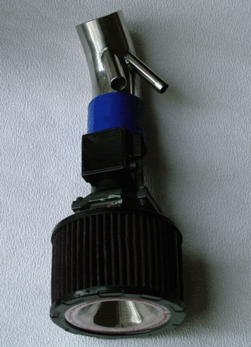

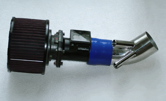

Hi Guys, What you need is one of these :wink: .
3 inch polished Stainless 45 degree bend with any combination of inlet pipes you need. This is the one I made up for myself and it has inlets for my SSQV dump valve and for my oil breather from a catch tank (these are angled back so the air flow comeing from them will not interupt the flow of the inlet to much). It's about 7.5 - 8 inches long and puts a filter right up behind the passenger head light. I made this because I already had a short stainless pipe that put the filter in the same place but it was badly made (not by me :wink:) so I made this one. I have taken some shoots of it assembled with the set up I plan to be using in the next few weeks (Z32 MAF and Apexi Super Filter) just so You can get some idea of scale, I am using it with 2 Samco reducers connected to the standard MAF and 2 inch turbo inlet at the moment and it put the filter in the same place. I have been running this set up for about 3 yearsmapped for 1.2 bar with no problems at all and I didn't think I was going to notice a great difference in performance but the turbo (GTRS) is definitely spooling up quicker and the car seems more responsive.
Anyone interested just let me know exactly what you need and I'll see what I can do.
