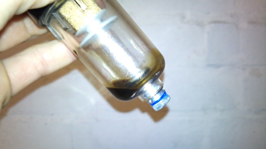

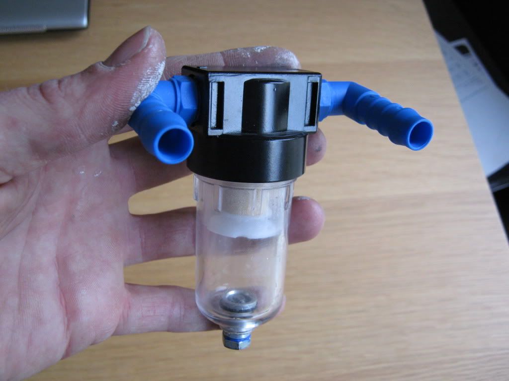

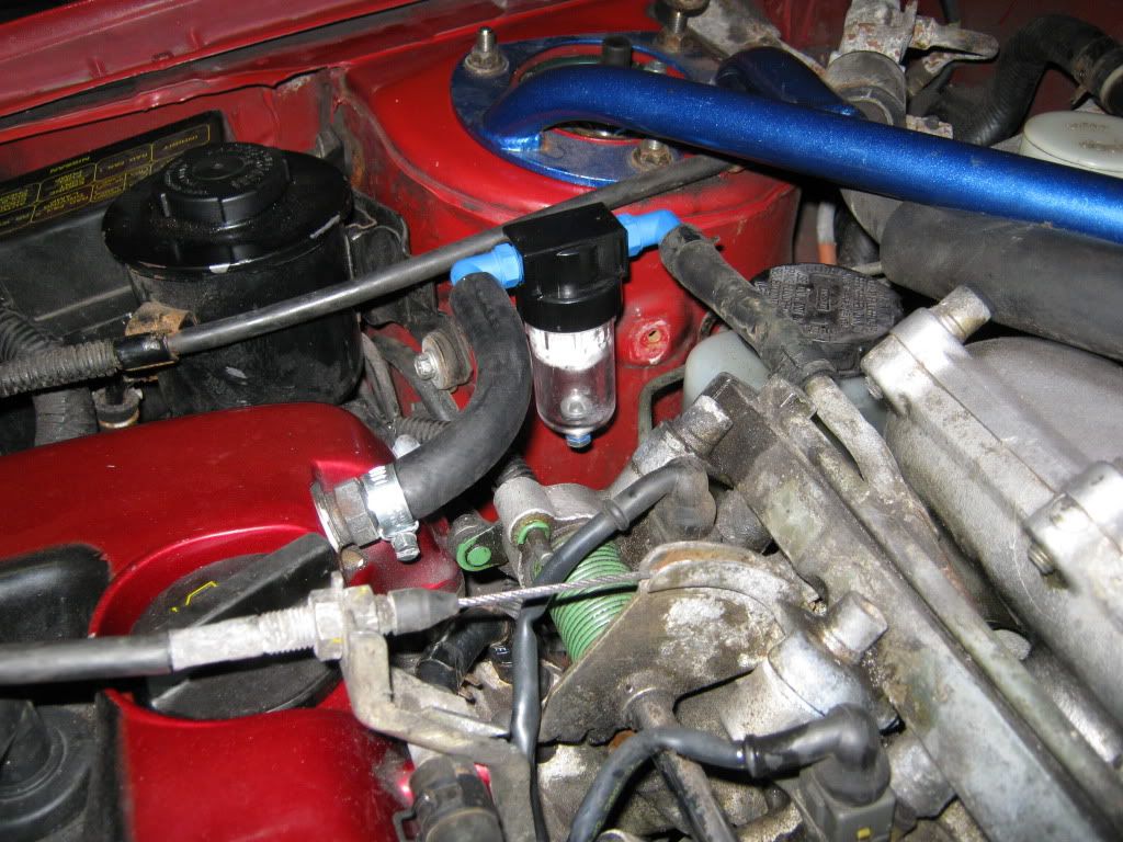

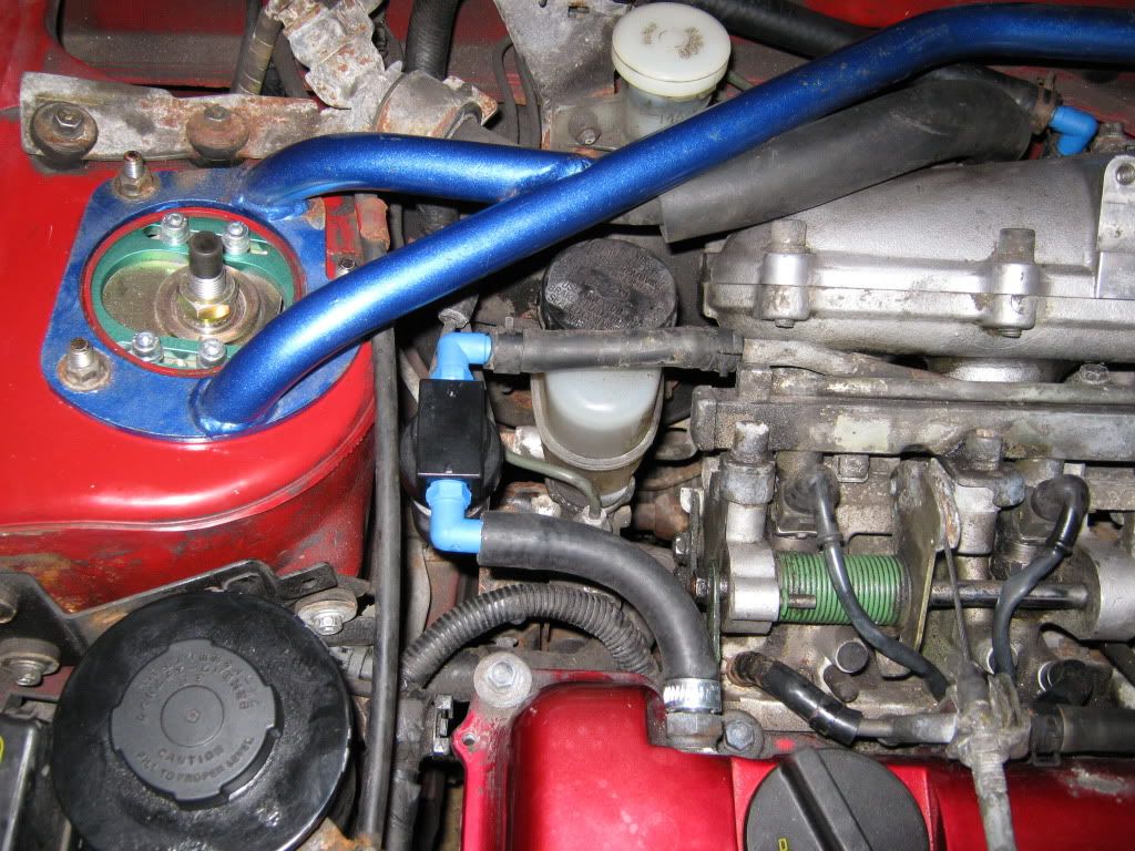

I thought i would try a filter between the pcv valve and t/b's and see how it goes. After doing a few searches it appears this is quite a popular mod in the states so i've copied what i found, sorry for the big pics.
The filter was just about £9 from machine mart and the fittings were £2.50 from ebay. It seems to be working quite well, this is after £20 worth of petrol.
