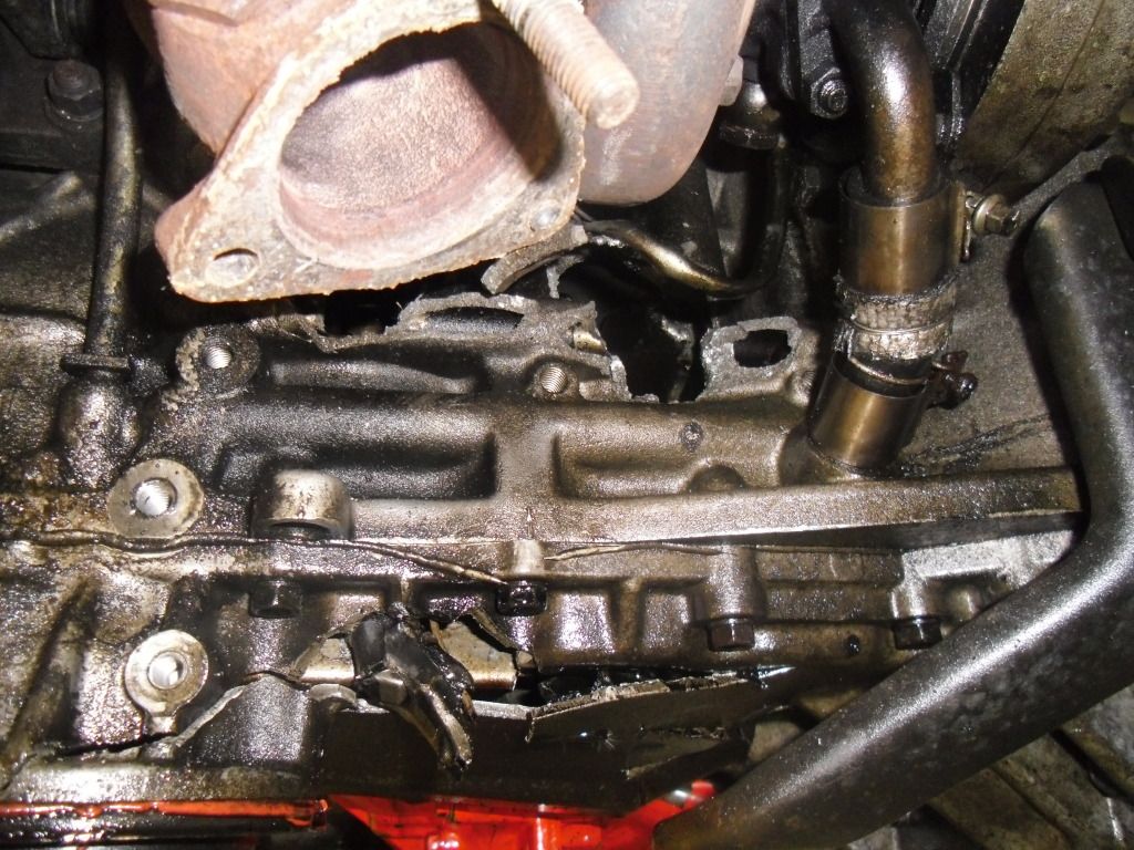

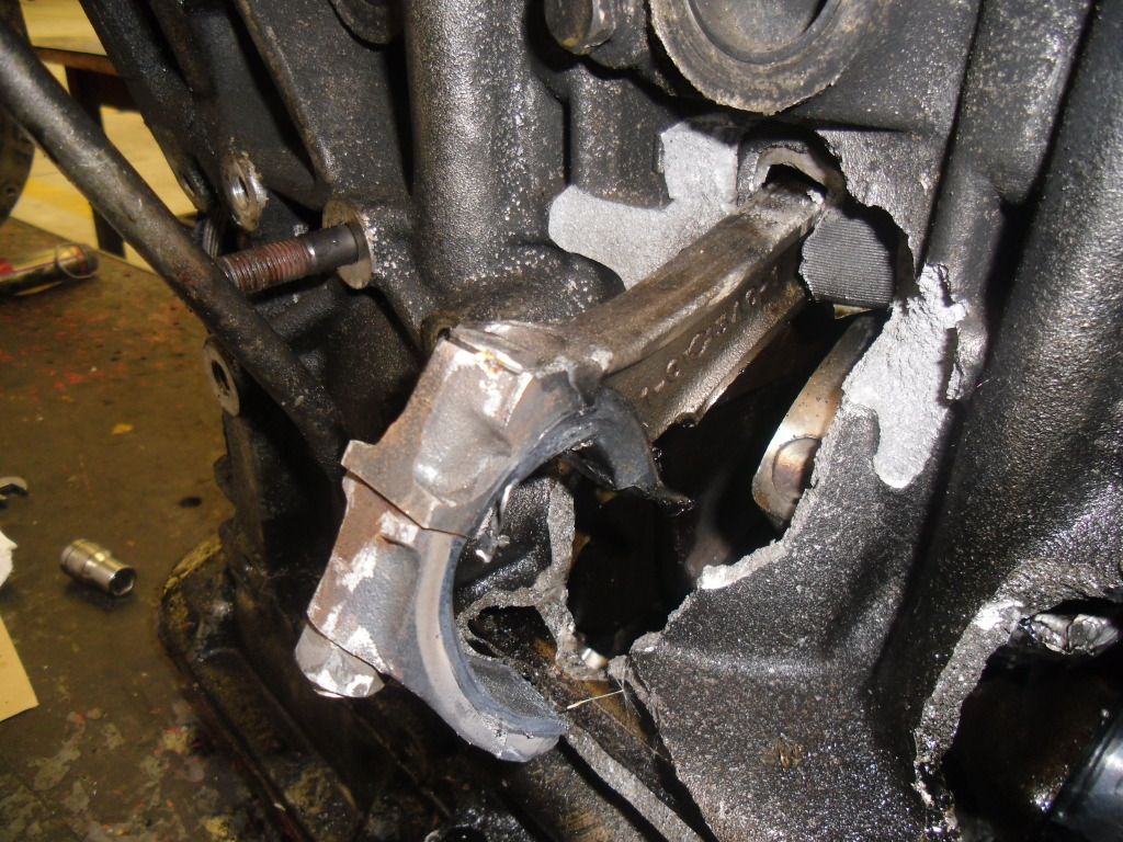

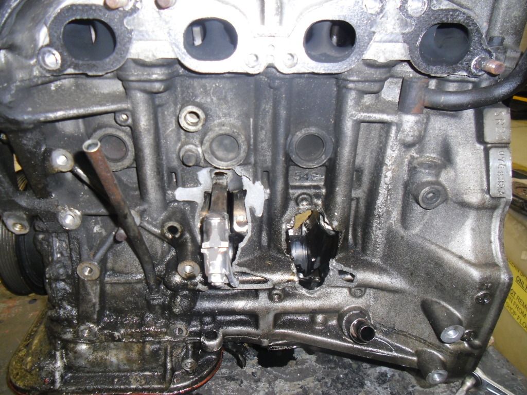

After rebuilding the car, schoolboy error of not checking over the engine, i was having a blast down the Autobahn when within 5 seconds there was a loud whining noise, no loss of oil pressure or overheating and then a massive explosion and i'll let the pictures tell you the rest :doh:

So if you had checked it over, what would you have found wrong? Throwing 2 rods is pretty impressive.

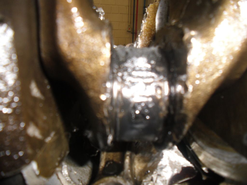

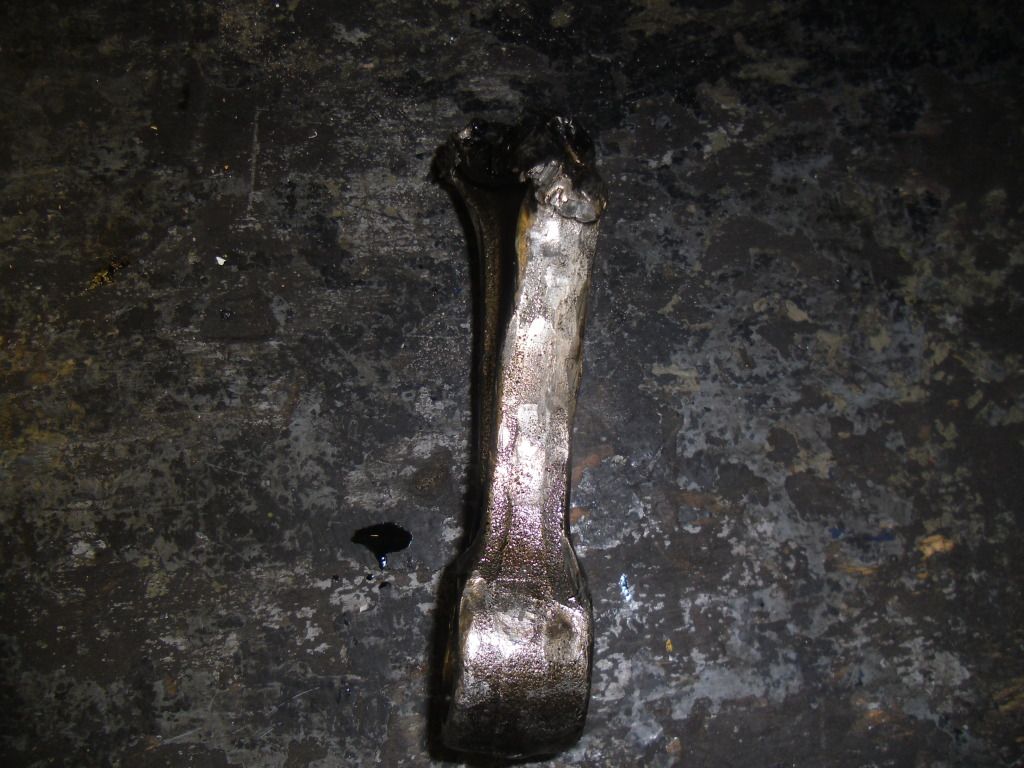

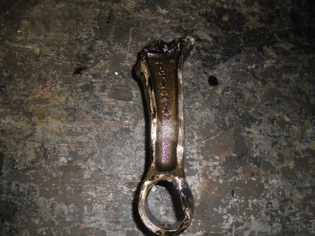

don't re-use standard rod bolt's.
The engine was working in my old car and as far as i know has never been stripped down before? so i just swapped it over complete during the the re-shell and didn't really check anything on it :doh:
Don't know why it happened, throwing 2 rods i can only think of is oil starvation at high speed? but it sure made a spectacular firework show in my rear view mirror at 160mph :evil:
one rod bolt snapped causing oil starvation to the 2nd, or the cylinders melted between 2 and 3 and it hydraulic locked........... nice to see it broken properley at 160mph...lol
HOw much power was it running pre DIY air-cooling?That will help answer a nother thread about what power the rods can take :p.
skid marks the rods will take over 500, the rod bolts are the weakness as standard just fit arp's and enjoy.
