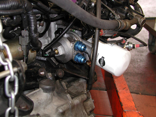

Oil Thermostat cooling.
davey red.r
thats the same as my setup now.

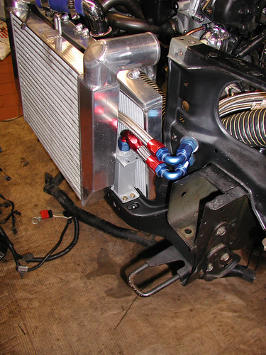

was a right bitch to fit with 3071 with 4'' intake, i ended up having to cut a lump out of the inner bonnet skin, doing away with the top slam panel and grinding down the front main strut as well as drilling holes in it to mount the ic / rad, its the height of the thing thats a real prob, but if your running a standardish setup then shouldnt be too bad a fit.
