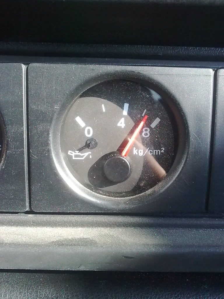

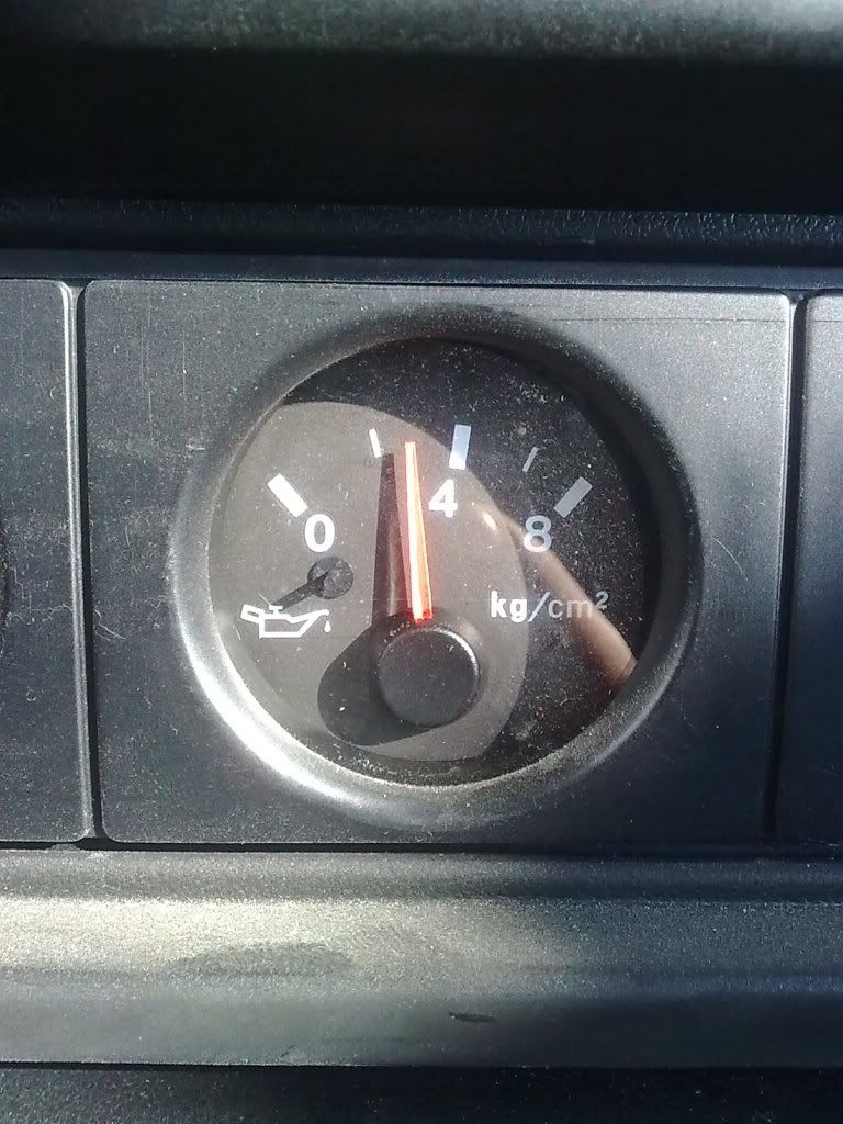

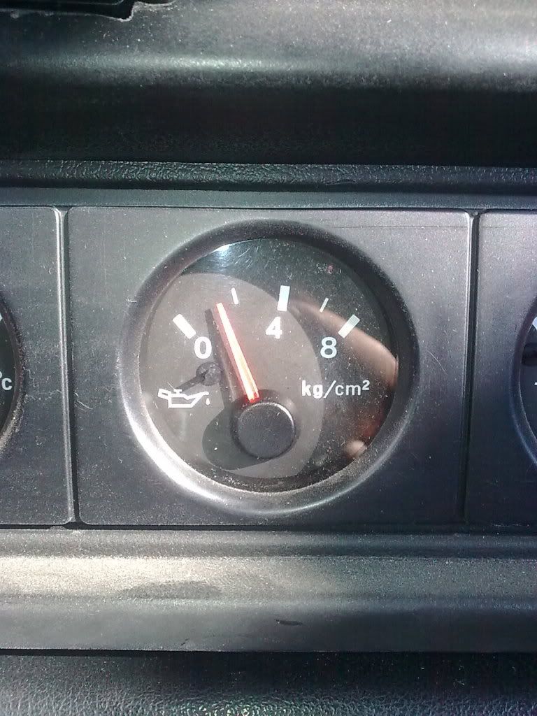

Finally I have managed to start the engine and I let it run until the oil and water went to 90 C deg.
The pressure at approx. 900 rpm (standard idle)
At 2000 rpm.
At 3500 rpm.
Please note that the oil is 10w40 (just for a little bit of engine cleaning....when I will do the MOT I will put 15w50).....and also because of my overfuelling problems it smells like gasoline.
What do you guys think???
Thanks,
Bogdan
It's above what the manual states, so shouldn't be a problem. 15w50 will probably raise the pressure some more.
Sort your over fuelling as if the oil smells that bad you're probably getting bore wash and slowly damaging the engine.

I have seen on gtirworkshopmanual that the pressure at idle should be above 1 bar and at 3200 rpm betwee 3.5 and 4.5 Bar.
That means that mine is spot on?
RO_SUNNY
There is nothing wrong with your oil pressure,in fact it is very good. that engine is very very good.
