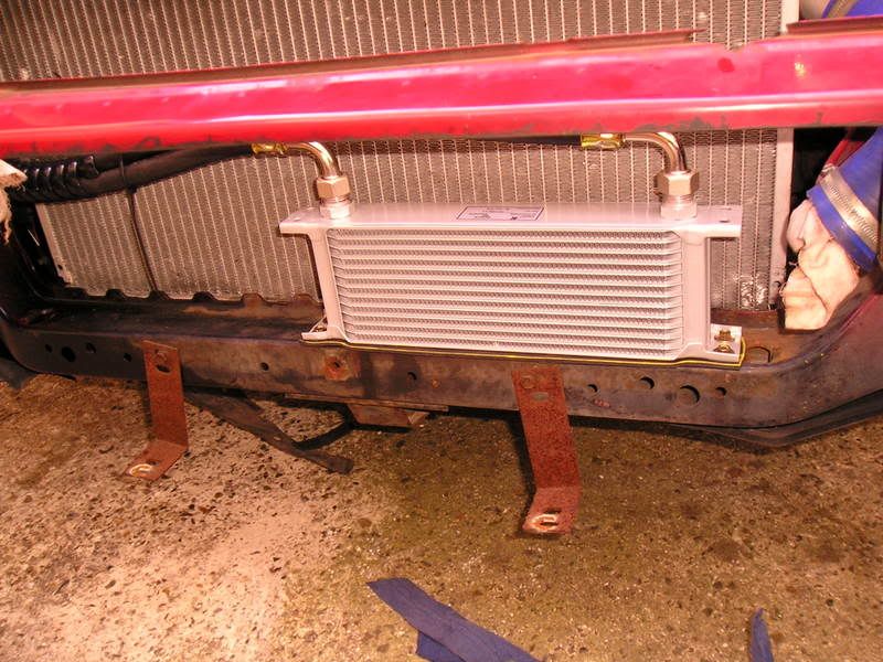

i originally bought all the bits seperatly. i bought a brand new 13 row cooler for a MGgt for about £35 deliverd, sandwhich plate with thermostat for £45 and i had proper swadged hoses made up at Pirtek for £20 (they done me a good deal as i used to work there). you could do the hoses cheaper without swadged ends.
i think it cost me just shy of £100, and it works a treat, mine is front mounted aswell.

no. all you do is remove the oil filter, put on the sandwhich plate, i used a bit of locktight on the thread, then fitted new oil filter and hoses.
