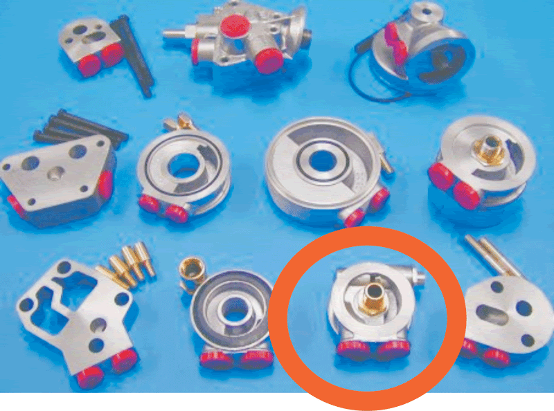

You have got 1/2" BSP threaded oil fittings, I'm sure.
Go to the http://www.thinkauto.com/index.htm website, click on the products button, then in the blue grided menu you will see "take off plates" in the top left hand side, click on take off plates and see the photo at the top of the page (as below), it's part number is OTSP1 and it's £41, tell them it's for a Nissan.
Pain in the ass to fit though, the threaded brass stud in the middle of the plate screws onto the steel stud thats on the block and the face you can see in the pic above is then the place you screw your normal Nissan oil filter to.

that looks like the kiddy - i tries to get it off earlier to measure the thread
but no joy! does look a bit hard to do so i'll get the garage to replace it
