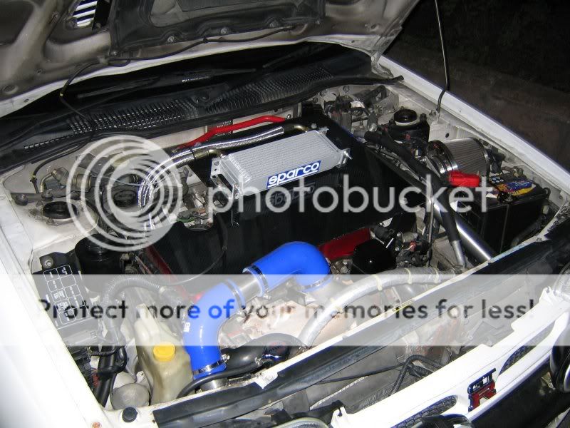

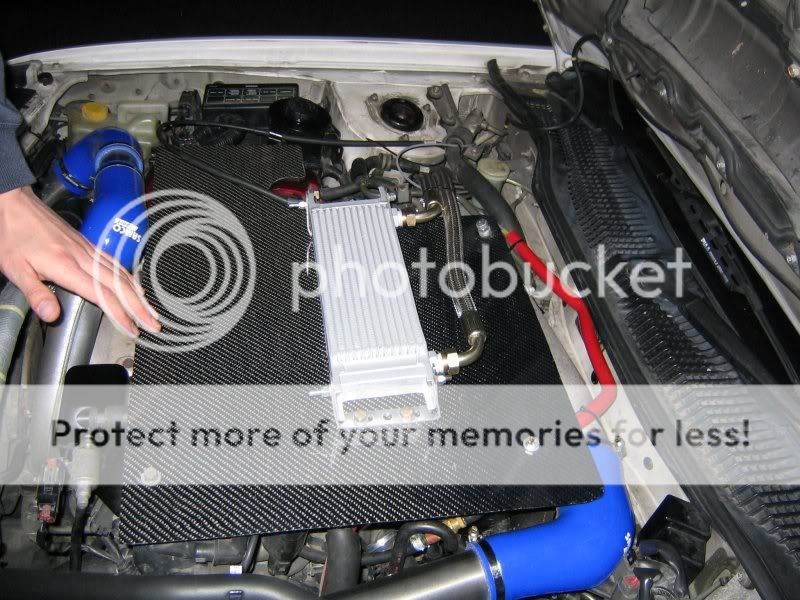

was a bit tricky to fit cus of the lack of room for the fittings, but only took a couple of hours :D
big diff on temps :D
i love carbon :)
B
BabyBhp
Never seen that b4 on a R let alone a car
Buts looks good 8)
B
BabyBhp
lol
ive never seen that carbon fibre cover thing before on a GTIR
and have never seen it on another car
S
srbpower
Nice work, works kinda like an underbonnet table but in carbon 8) first course.... oil cooler :D
na very nice :)
Si :)
D
DodgeT
all me own handy work :) thats probably why you aint seen one before :D
after fitting the front mount, was gonna make a cover for the spark plugs, saw you could buy spark plug cover & injector cover & dizzy cover, so thought why not make it all in one :D
it just so happened then to be the perfect place to mount the oil cooler
dont think it does much for heat soak, if i wanted it to cut down heat soak i could of lined the bottom with aluminium foil.
My thinking is with the cooler there, the engine heat will help the oil warm up quicker than having it insulated & the air can do its business cooling the oil when on the move.

Only problem is that you shouldn't have blocked the back end of the oil cooler like that, it doesn't allow the air to circulate through it. Just like blocking the back of your rad.
Yodi
D
DodgeT
there is quite a gap under the cooler for the air to escape, its just you cant tell in the pic :D

So what oil temps were you getting and what oil temps are you getting now because I also have an oil cooler but cannot decide were to mount it :?
D
DodgeT
only drive car at weekends.....
2 sundays ago, hot day, was getting over 110deg
sunday just gone, another hot day, stuck between 80 - 90deg

Looks like I do not need to mess about trying to fit it at the front as there is not much room for a 19 row oil cooler :shock: with my Forge front mounted intercooler :wink:
Do you think that the carbon stops some of the heat as I may do it like yours but with a small piece of carbon just to mount the oil cooler onto 8)

I assume two sundays ago you never had the oil cooler fitted?
D
DodgeT
yep, only fitted it saturday.
the carbon does block quite a lot of the heat from the engine, as i said before, you could line the bottom with silver foil/tape for greater effect. 8)
