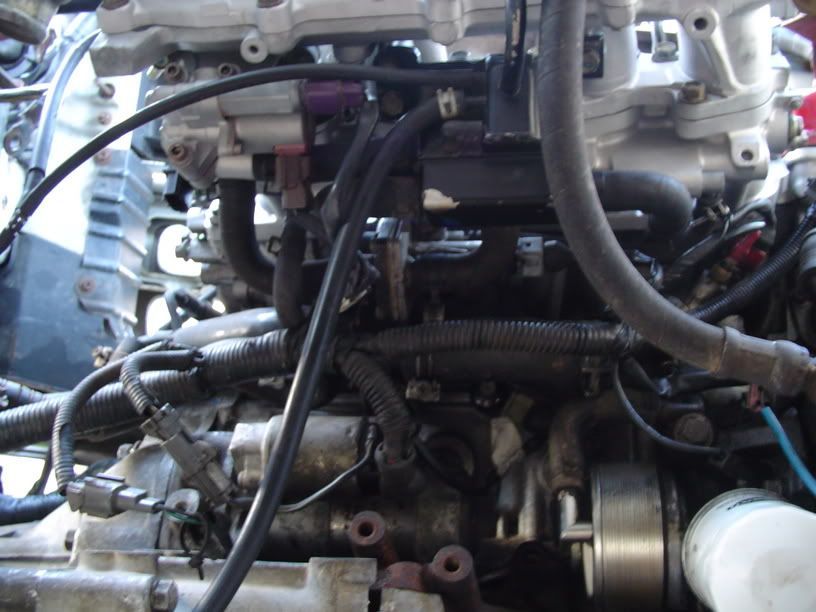

The speed sensor is in the transferbox below the starter motor, you should be able to get to the connector but its a bit fiddly :wink:

You can see the connector for it in this pic :wink: Although the engine was on the floor and theres no brackets in the way :lol:
